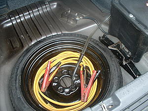

I pretty much did my relocation like this how to.
https://www.evolutionm.net/forums/ev...-kit-evo8.html
I used a 2 gauge wire, which will work fine unless you plan on having an aftermarket sound system. 2 gauge is the smallest I would go. 00 gauge seems like a bit overkill though. Keep in mind your using ~5-7 ft of cable max. here is my trunk setup:
