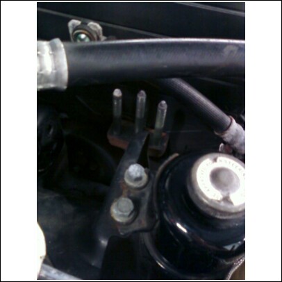

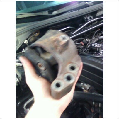

I did the passenger side mount yesterday and snapped some pics while I was doing it. It's a camera phone so sorry for the size.
Up on the lift.. I lowered the lift to one of the lowest locking positions; so I would be able to get around underit with the jack, but also work in the engine bay with ease as well.
I used a 2x6" board to distribute the pressure from the jack across the exhaust pipe and the cradle... When I was lining up the bolt on the new one I ended up moving the setup to the exhaust/oil pan to get the side up a little more even.
Once the jack was positioned to support the engine from moving without the side mount supporting it, I unbolted the long stud that goes through the center of the mount, then the three smaller bolts that hold the mount to the bracket on the block. Then it came right off.
The old mount was rusty and had a lot of play in the rubber. I could easily move the center section a half inch or more with my hand just pushing at the hole sideways.

Installing the new one was straightforward. I just needed to get the support from the jack positioned just right to line up the mount to the holes for the stud.
Impressions?.. I don't feel a huge difference, but it seems like I have less cabin vibration, and a slightly more responsive ride. I do notice more vibration in my steering wheel and console though. Nothing too unbearable. Ill be doing the driver side and lower/front soon, and I'll take some more pictures for those.
