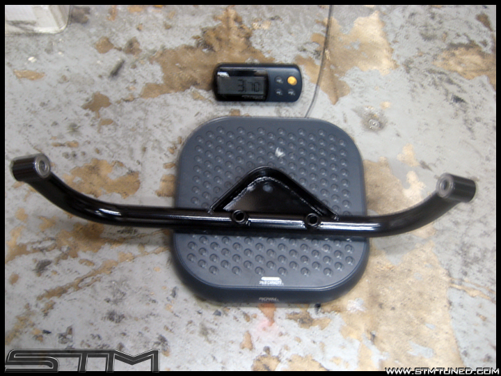

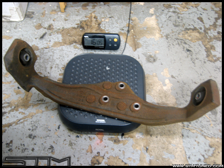

Here's some more weight off the car. Got it up in the air and went fishing.
Stock brace vs the Buschur.

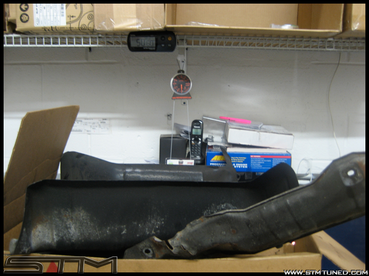

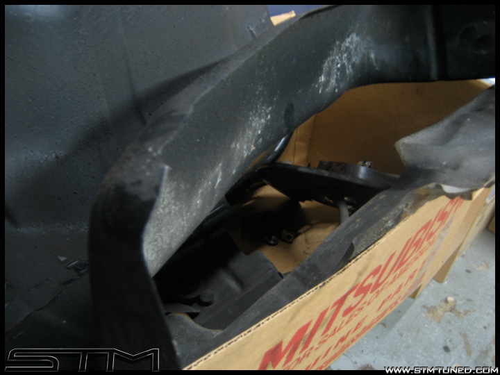

And, here's a 50 pound box of crap.

Woah, that brace weighs a ton compared to Buschurs
