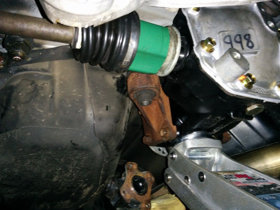

any tips on getting the cv axles back into the diff? i got one to pop in but the other will just not go in...
how clean should the joint piece going into the diff be btw? i got a little bit of dust on one
Clean it up, grease it with a light coat and if needed tap the cv joint housing if you meet resistance, try using a 2*4 to protect the housing.
HMMM, There is just a clip on the axle (or in the diff) that snaps in to place just like a Honda. I do remember having a similar issue just cant remember how I resolved it. Is there a flange on the aluminum color part after the cv joint that you can tap. Just that the cv boot is fragile and the cv slides absorbing force if you push on the axle end as I feel sure you have.
okay fairly certain what the issue is - the axle has a little bit of spindle, retainer clip, and the rest of the spindle. i can just get it in so that the first bit of spindle is in and engaged with the driveshaft, but can't get it in any further for the life of me.. i think the retainer clip is just refusing to go in.. any tips?
Just saw your email...long weekend for me I'll tell you about it later. Anyway I had a similar issues getting one of my axles to pop back in actually. Unfortunately I don't recall what I did to get it to seat.
My recommendation would be to lower the diff down a little and physically push the diff to the side where it wont pop in. Assuming the splines are properly lined up it should just pop right in. This may pop out the other side in the process but sometimes it'll fight you and other times it wont.
If that doesnt work then try the opposite and bolt up the diff so its sitting where it should be and then just pop that sucker in there. In the same manor that it requires a quick jerk to pop out the axles just give it the same quick jerk inward. I really don't have any other useful info to add. I do remember mine doing the same thing but just played with it a little and go it in there.
just tried to hammer it from the silver plate with a 2x4 and it just popped off the axle so i guess that's not the way to go...
the ring must have gotten deformed it's just not really going on there
