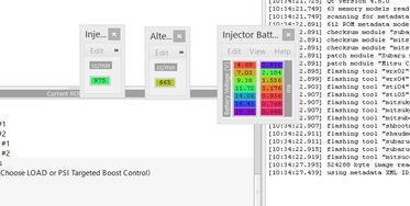

Heres whats inside the rom to give you a idea of its major things that make the car feel how people are experiencing it differently:
This is just a snippet from my 6 map rom.
so you see
1. throttle position vs vehicle speed
2. front / rear speed difference vs vehicle speed
3. steering angle vs vehicle speed
Should make more sense now how it does what it does.
so you see
I see now, thank you. That's pretty awesome. My tuner needs to get in on this LOL
