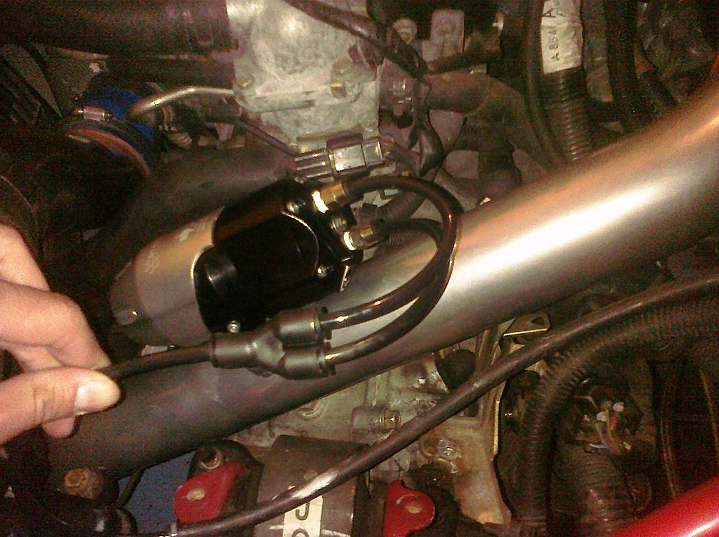

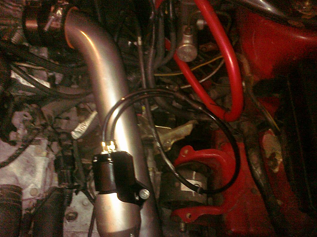

I think it might have to do with my BOV, after reading Synapse's wesbite i can see that i am suppose to have a port c for a boost source but my bov doesnt have a port c.
Im going to attach some pictures, does it look right?
I also took a close up pic of the bov where there should be a port c!

On the new Synapse BOV Port C has been internally plumbed and take the pressure directly off the charge pipe.
this makes install easier and you dont have to worry about tapping a boost source.
A+B into vacuum and your done.
Devin
