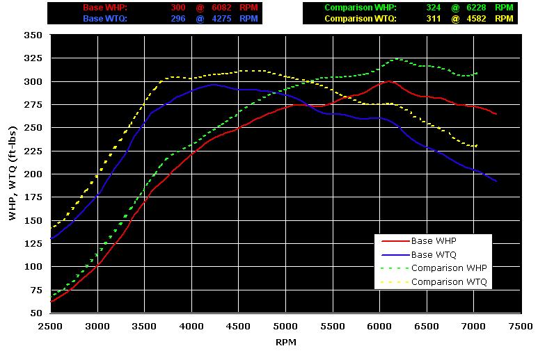

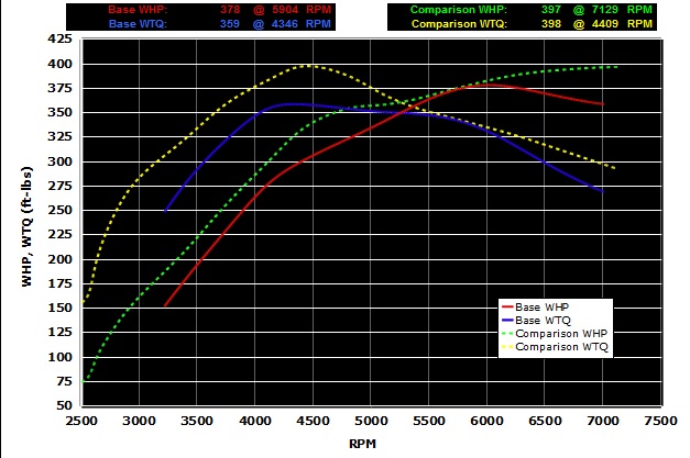

Well, it's going to be different on every setup, of course. Peak numbers will vary, but most of your loss will be under the curve. Depending on how much boost you are running and if you are maxing out the turbo, the absolute peak HP numbers may not be that different (for the stock turbo), but the amount of early torque and area under the curve will be.
Let me find some runs that I did. I hate running with my cutout open, so I only saved a couple. I think I have one at lower boost on 93 and one at higher boost on E85, where I got a little induced knock, so it effected the comparison, but you will get the idea.
Higher boost on E85...some knock with cutout open, so that is why the midrange dipped down, but you get the idea:
Lower boost (I think on 93). I have this posted in the VDR thread with screenshots of the LogWorks log as well here.

^^ Very informative and just what I was looking for, thank you! I guess if you had just used a test pipe and the stock catback it would have been very close to the cutout - within 10 hp above 6000 rpm.
What turbo and cams are you running ? Thanks again!
I don't know about that...the stock catback is pretty restrictive. I don't know how far off you would be with a test pipe and stock cat-back, but I would imagine it would be somewhere in the 20whp on stock turbo. Removing two restrictive parts in an exhaust isn't necessarily going to have an additive effect.
