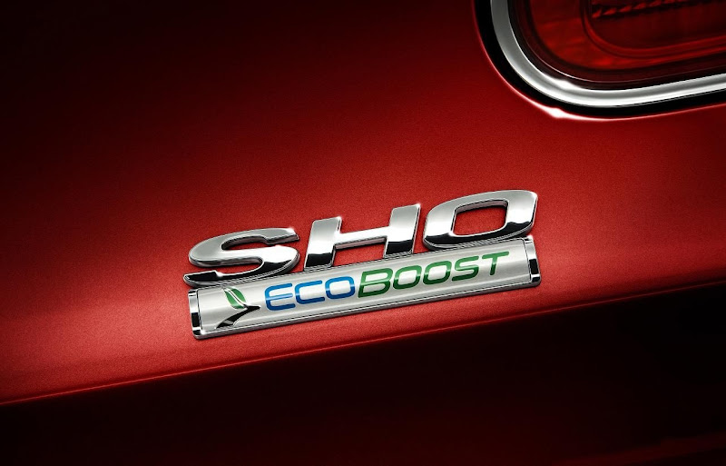

Flexfuel Badge for the win
EcoBoost for the even bigger win.
Looking to get the Tauras SHO Ecoboost badge since its bigger. (Just gotta dremel the get a modified Evo on it)
