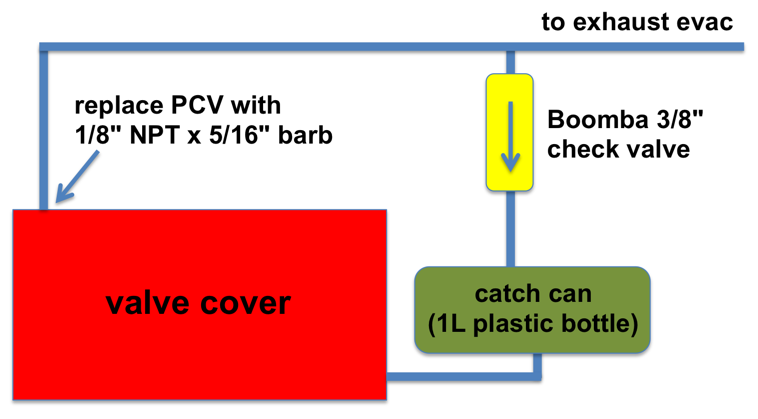

In my quest to minimize water and unburnt fuel in the motor oil without using the stock PCV system + catch cans, I put further effort into an exhaust evac solution. I built my own exhaust evac nozzle using some 3/8" copper tubing, and now I can pull a bit of fresh air into the crankcase during idle and light cruise, and it pulls a pretty good amount of fresh air into the crankcase during decel. It pulls no fresh air under boost though, and instead, it closes up just like the stock PCV system. Its still not nearly as effective as the stock PCV system for pulling in fresh air, but I have decided that its better than just venting the valve cover to atmosphere. I have figured out how to make an even more effective nozzle, but its not something I can make in my garage. I'll have to head over the English Racing to have them build it to my specs.
To deal with crankcase pressure under WOT, I took a queue from Steven's setup, and put a Boomba check valve (they are really nice) in a hose that Tees off the evac hose as shown below. With this setup, my crankcase pressure went from 2.2 psi under WOT peak rpm with the stock PCV system down to 0.75 psi with this setup. I figure that once I tap the driver side of the valve cover for -6 or -8 AN, crankcase pressure should drop to less than 0.5 psi which is plenty low enough for me.

Great thread. When you get this stuff sorted out mrfred, I think I might be interested in doing something similar so hopefully it works out. Short of a dry sump system this looks promising. One story I remember from an engine builder friend I knew that worked at Rousch Racing in North Carolina, He said that their dry sump system was pulling so much vacuum in in the sump that while the engine was on the dyno they noticed they forgot to install the rear main seal and it wasn't even leaking a drop. It has been a while, but I want to say the typical Nascar dry sumps, at least back then, were pulling around 18inHg. in the pan.
Even what you have now, going from over 2 psi to only .75 psi is awesome imo.
