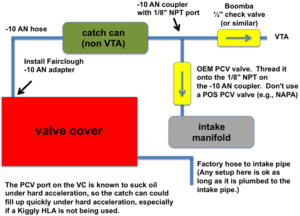

Here is a breather option that maintains the factory PCV flow, provides good crankcase ventilation, and does not require drilling the valve cover. The downside is that the PCV port is known to suck oil under hard acceleration, so the catch can could fill up quickly under those conditions, especially without a Kiggly HLA.
Thank you. Those were my plans exactly. Just wanted to confirm if there were going to be any adverse effects of having the larger port on the PCV side. I have the Kiggly HLA so I can just monitor the can closely.

As long as an OEM PCV valve is used in the location I show, there will be no adverse effects of this layout. Also, the check valve needs to have the lowest possible crack pressure. I mentioned Boomba because I have one, and have found it to have a low crack pressure.

Mrfred so with the latest version of your catchcan setup the vta check valve opens under boost and the pcv closes due to boost and pulling vacuum it's reversed? And with a kiggly hla how quickly is quickly, I'm looking at this for a dd so I don't want to be loosing too much oil because I am passing cars on a long drive. Not trying to argue just understand the dynamics more.
Correct.
At this point, I have not noticed any additional oil coming out the rear of the VC under normal driving or WOT straight line.
