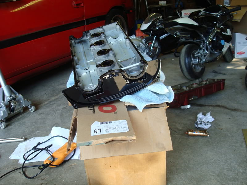

see all the stuff in the valve cover? those are baffles
Old Nov 19, 2010 | 01:47 PM
  #115
LGshow19's Avatar
iTrader: (51)
Joined: Feb 2010
Posts: 1,640
From: San Antonio
I wish i could draw a arrow in this pic...
Everything??? so how do you know how far above to drill?
drill out the existing hole and then make the other side the same as the other side as long as its in line with the other hole you know its above the baffling. sorry took so long to reply.
Old Nov 20, 2010 | 02:30 AM
  #117
LGshow19's Avatar
iTrader: (51)
Joined: Feb 2010
Posts: 1,640
From: San Antonio
ight now i understand... that makes more sense... thanks man
