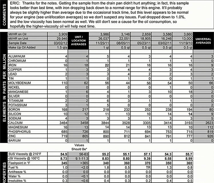

New UOA from me. 5W-30 Amsoil Synthetic. (Had to reduce quality so I could get it under the 100KB upload limit :S)
I just put in some 20W-50 ZROD Amsoil for summer time
Attached Thumbnails Some current oil analysis info, ongoing testing.-evo-1x-030212.gif

^^^^ Has Blackstone given you any recommendation for mileage when you change your oil? Based on the viscosity and flashpoint results, it looks like you should be changing it closer to 2700 miles than nearly 4000.

They've generally recommended me to move more towards 3500 rather than under 3000. Switched to 20W-50 ZROD now for summer so we'll see how that holds up after a couple track days.
