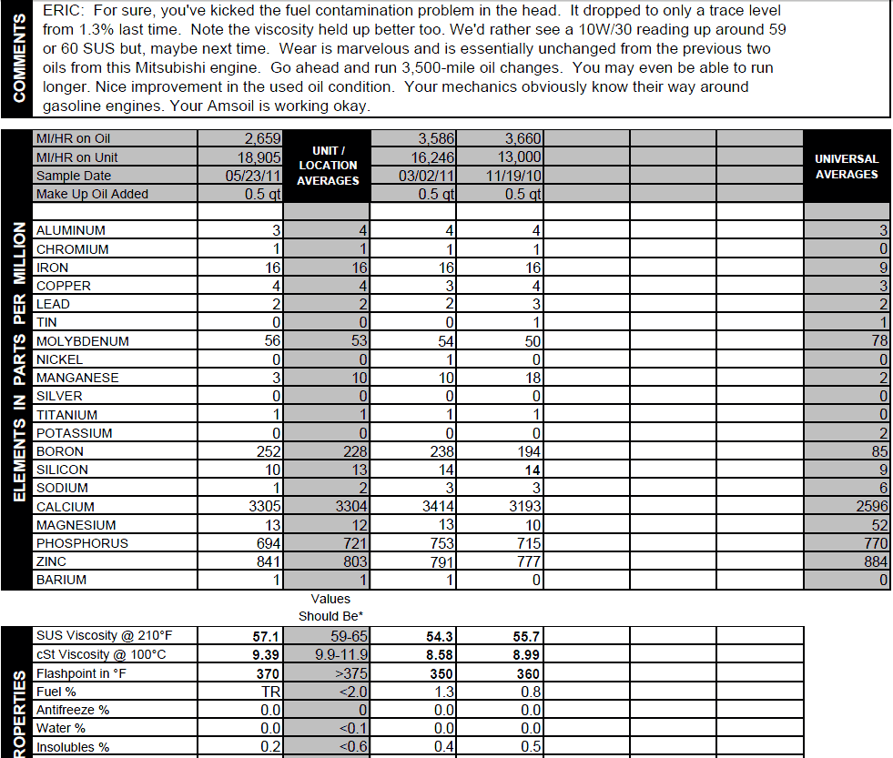

Speak of the devil, my analysis came in today! Things look excellent:
Andy, I'm going to be ordering some more oil from you sometime soon, would you recommend me sticking with the ATM 10W30 or should I switch to something else? I'll be running a few track days per oil change this summer, so maybe the new high-ZDDP oil?
(Built 2.0 engine btw)
Attached Thumbnails Some current oil analysis info, ongoing testing.-e59103.gif

added your UOA to the first page, thanks.

You could run the Z Rod 10W30 or stick with the ATM 10W30, i noticed Blackstone said you could run 3500 next time , they are being way to conservtive you can take it to 5,000 no issues,specially after how your analysis came back like.
