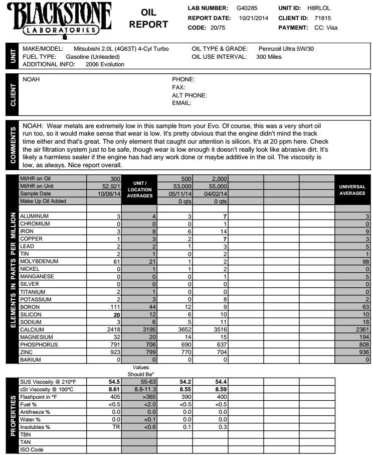

300 miles and two track days:
Attached Thumbnails Some current oil analysis info, ongoing testing.-untitled_zps2e1e1cc6.png
One thing I didnt care about the Ultra 5w30 is that its on the thinner side of a 5w30, for road racing purposes I like to play it safe and run something a tad thicker. Im glad its worked out for you, your a braver man than me.
Thanks for the UOA btw.

It's a step up from the 0W30 I've been running in the car for 48,000 miles.

The TDS (Technical Data Sheet) for Rotella T6 is a little skimpy on information I noticed. Nothing about ZDDP. It does give viscosity though:
Kinematic Viscosity @ 100 deg C is 14.2 cSt
That's higher than Mobil 1 0w40 which is 13.5 cSt (from Mobil 1 TDS)
and a bunch higher than the Ultra 5w30 which is only 8.61 cSt (golgo's UOA)
