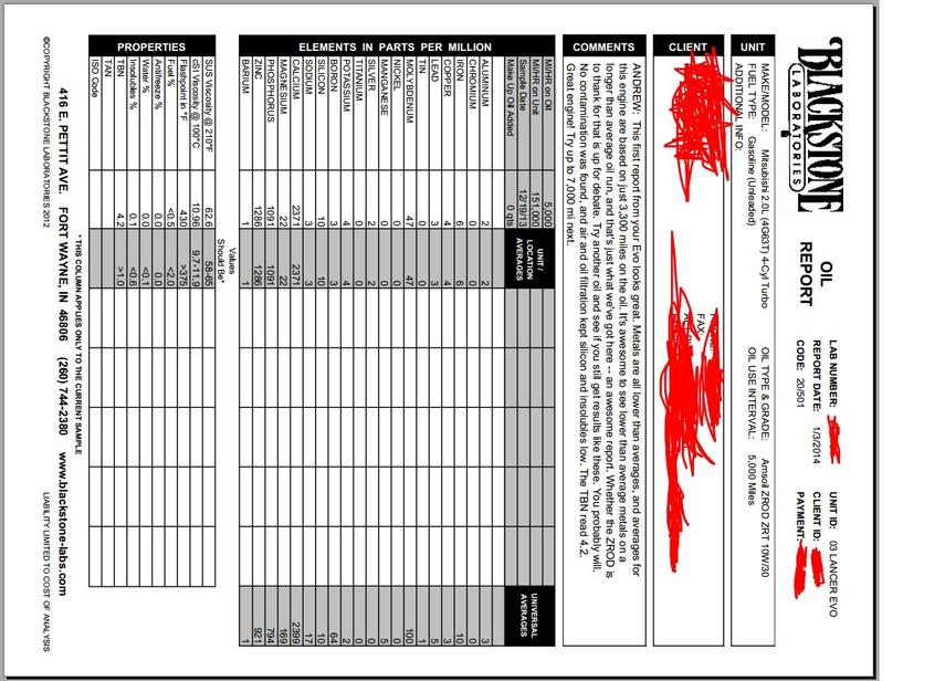

Originally Posted by Drew1
Z-rod 10-30 attached
Thanks, would you happen to be able to have it in a Jpeg format?
No problem, maybe just rotate

Thanks. got it saved correctly but still uploaded sideways, weird. Ill have a UOA from Zrod as well up soon.

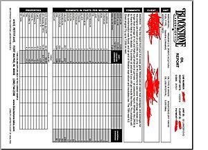

Added mine to the list.

Interesting how the lab said aluminum and copper on the high sside, I am not sure 7 is anything worth of mentioning specially given that this car is raced.. but they had to mention it for awareness ok I can live with that.
how about the iron which is on the high side ?
Also to say that 0w30 is on the low side duh it is the lowest 30 weight engine oil one can purchase.
I know you won't run past 5 on the oil... but did the lab look at the TBN this oil had left ? Wow did they mean 12k miles or 2k.

2k on that oil. To and from the track twice and two race events.
