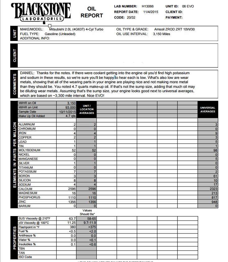

Here is my oil report. Car has bolt on's and a tune around 330-340 all wheel hp 93 octane and 93k miles. Ran 10W-30 Signature series for a good 40k miles and recently now using z-rod 10W-30.
Attached Thumbnails Some current oil analysis info, ongoing testing.-oil-analysis.png
