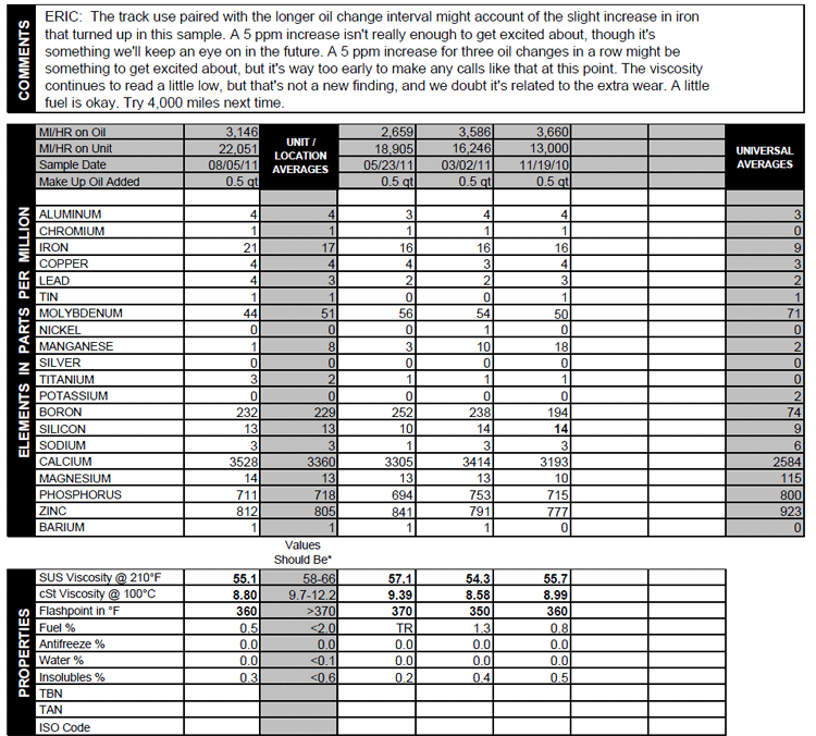

Another UOA from me!
what oil you were using this time? want to make sure before I post it up. thanks again for the info.
Amsoil 10W-30 ATM

Thanks Raptord and TougeGod7 for your UOAs. They have been added to the first page.
