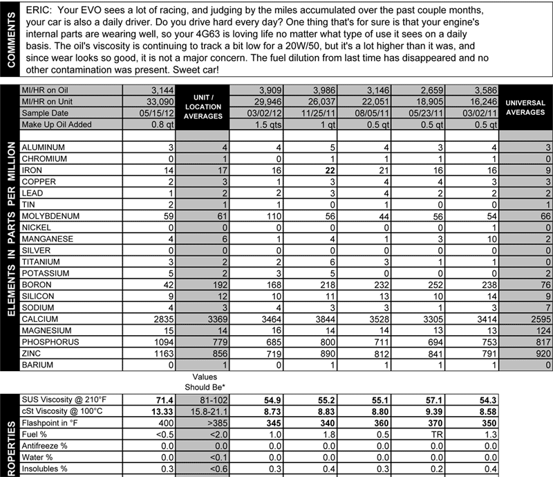

As promised, here's my UOA on Amsoil 20W-50 ZROD:
Attached Thumbnails Some current oil analysis info, ongoing testing.-2012-06-25.gif
