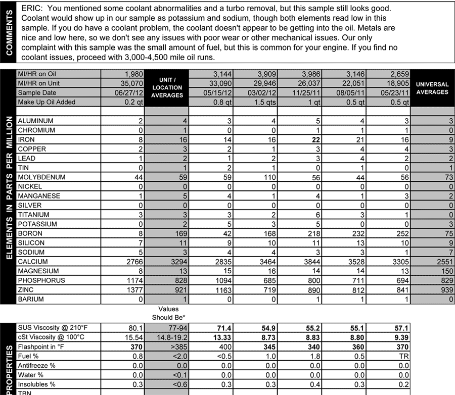

Oil: Amsoil ZROD 20W-50
1980 miles
Attached Thumbnails Some current oil analysis info, ongoing testing.-2012-10-19.gif
