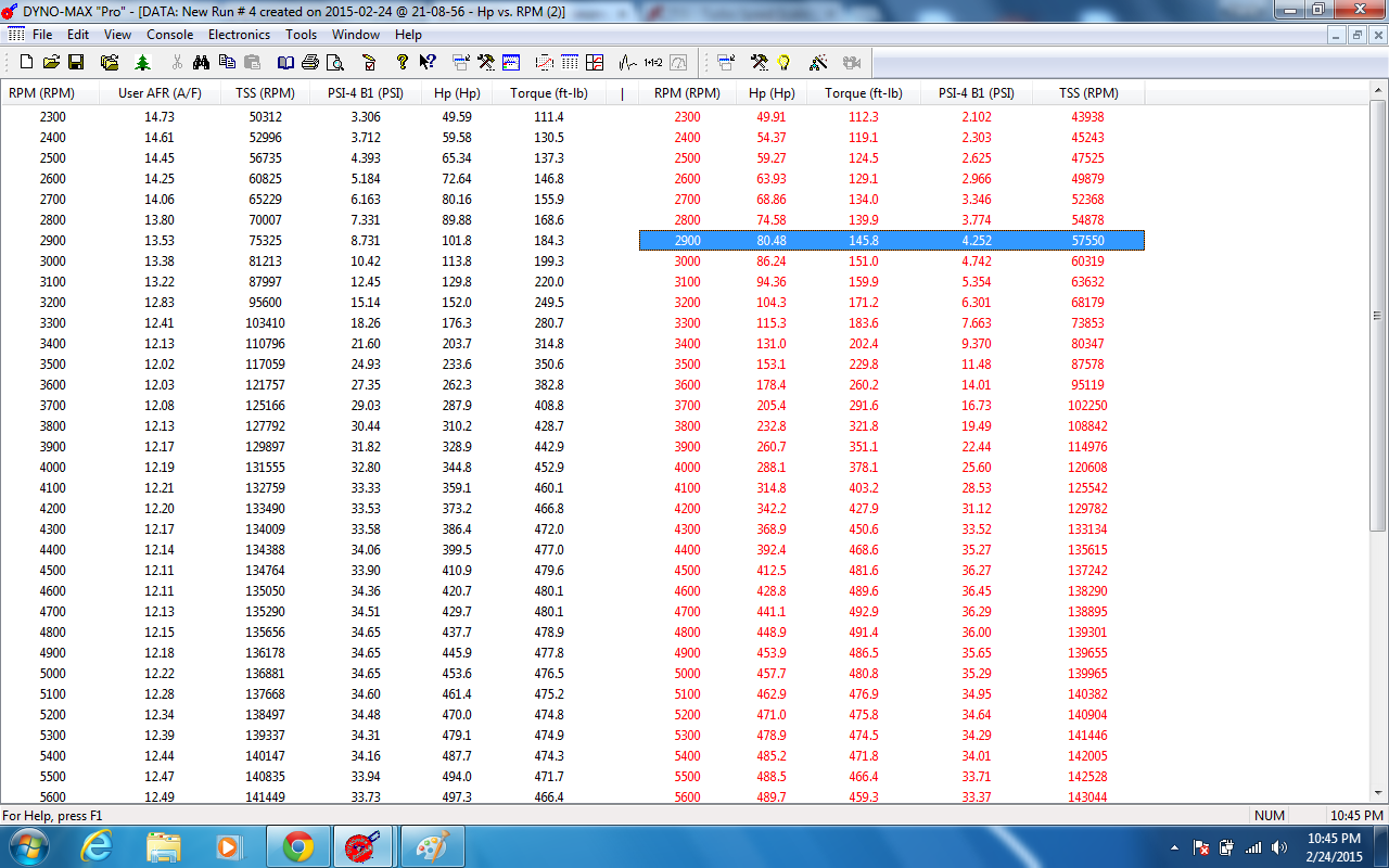

If you guys are horny on t4 transient and spool pickup, just wait till the BWTS VTV device hotsides are released. We have tested every EFR turbo(6258-9180) with a QSV style valve built into our 2.2L i5 Audi manifolds, and the results are insane if you control them correctly. It takes a bit of work to get a valve like that happy, as you are virtually dropping EMAP when you open the other vein, much like a wastegate does. With good PID controls, it isn't too bad though.
The eventual BWTS offering should be even better, with better durability and slightly higher top end due to not having a blade in the flow vein.
Raw data 7163 EFR .80 T4 2.2L i5 20vt. Black valved, red open t4 e85
EFR7163, .80 T4 with Valve, 2.2L 20vt i5 e85

Looks fancy, but still a few years away.

Bbk-b kills this data
And HKS 7460 knocks it out of the water
10psi at 3000,
Bbk-b on my E8 did 10psi at 2500rpm...15psi at 2750....by 3000 all in.
I swapped to Bbk-because before it the HKS 7460 was even "worse": spooling to 12+psi before 2500, surging despite best effort to control.
Have to believe 7163 can do better!

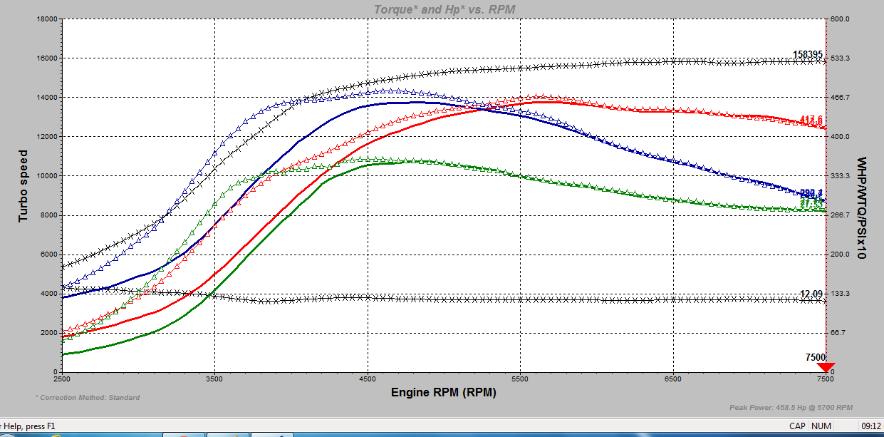

Here is some 6758 data on the valve. Our Land and Sea awd dyno reads about 3% lower than both local mustangs to us, and about 16-17% lower than 2 dynojets local to us. This is done on our test mule Audi S4
6758 .80 t4 on e85 2.2L i5 20vt with Valve and without valve(solid lines) Green boost, red Whp, blue WTQ and black TSS
10psi at 3000,
I dont see a BBK-B-BB making the power of the 7163 when we have final testing published
but The 7163 isnt spooling like the BBK-B-BB either- to be expected
