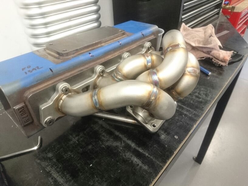

Hypertune EFR 'Tilt' exhaust manifold all finished. Like all their manifolds - flanges, collector and runners are cast entirely from 347 stainless
Exhaust is next, hopefully theres enough room for a nice 3.5" front section. No AC and ARC slimline radiator in my car so we're confident theres more than enough room to squeeze everything in

Looks great. Which EFR turbos will this work with?

Looks good minus those cheated short radius bends on #2 and #3, but probably not much you could do there. Also looks like you're gonna have about an inch and a half if not more of length between runners

Pete told me it was made for the 7670 and smaller EFRs with external gate hot sides.
Although this won't fit the 7163 unless they have a V-Band collector for it.
This manifold still looks more equal length than my Full-Race to my eye, but then again Pete could not guarantee IWG fitment with A/C with this.

I don't think there will ever be one unfortunately. Going down the EFR route is expensive enough without our sh!tty Aussie dollar working against us, most Aus guys end up sticking to stock frame stuff
7064 & 7670 (T4 EWG turbos). They have another to suit the larger 8374 & 9180 (and various other Precision, Garretts etc), again in T4 EWG config only
I've had ToxicFab and FullRace manifolds, neither were close to being equal length. The Hyper manifolds used on Tilton & Scorch aren't either (they're making close to 1,000whp), good enough for those guys - good enough for me
If you retain AC you end up with a mediocre front exhaust section, wasn't prepared to spend the big $$$ on a EFR kit only to have an asthma inducing exhaust off the back of the turbo haha
