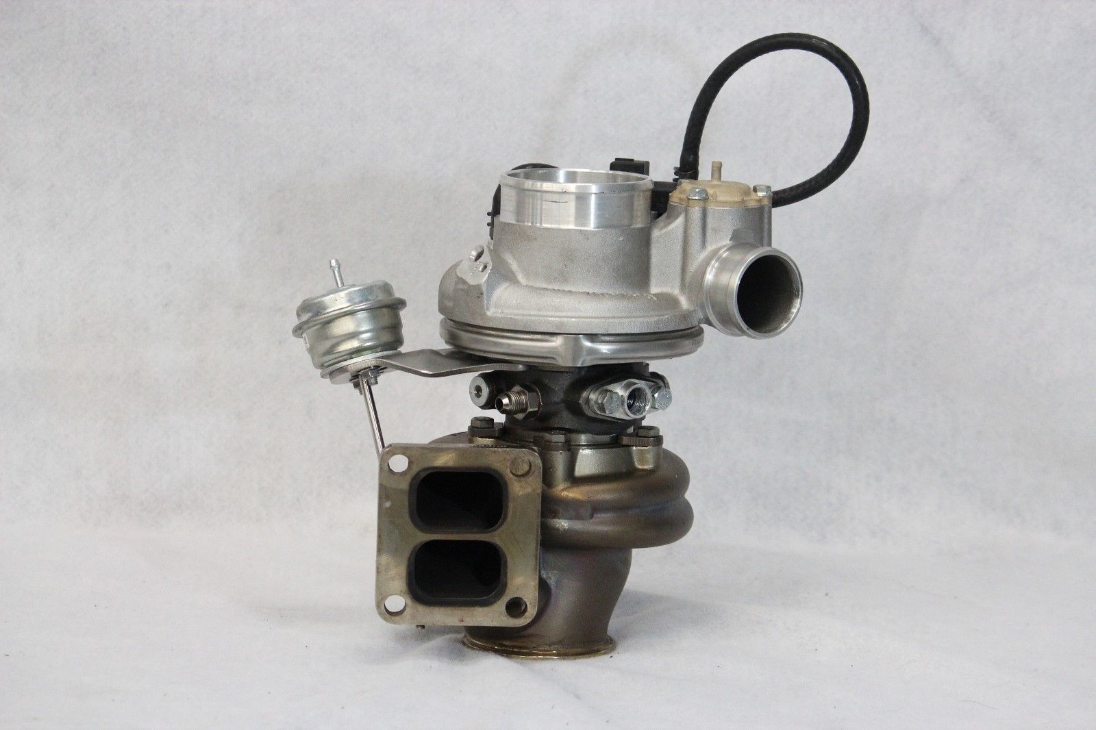

I know this probably won't apply to any of you but i'm after a bit of advice. I originally wanted to use an efr 6758 t25 as my power goal isn't any higher as 450, however i can now get a 7163 alu cored ts turbo for only €150 more.
Btw, a 6758 ts is an option too at only €80 more than the ss 6758
It's for a fwd car so torque would be limitted anyway, also i'd have to fab a mani for both so no problem in that regard...
How do ts cars sound compared to ss? Because of the restrictive nature of the original ts turbo it sounds like a coffee machine, wonder how that works out with the BW's.
Your views are highly appreciated!

I'm joining your clique club, just scooped a 7670 with .92 IWG for $1000 for my Evo 1.

Originally Posted by RS200
hay guise!
cant imagine that fitting well in the small engine compartment. surely no a/c and the radiator stuffed under the core support. and it still may not fit.
Old Dec 2, 2015 | 03:38 PM
  #3690
RS200's Avatar
Joined: Dec 2008
Posts: 622
Likes: 118
From: Winnipeg, Manitoba, Canada
It's an RS so no AC, and tucking the radiator with a pusher fan is the plan.
