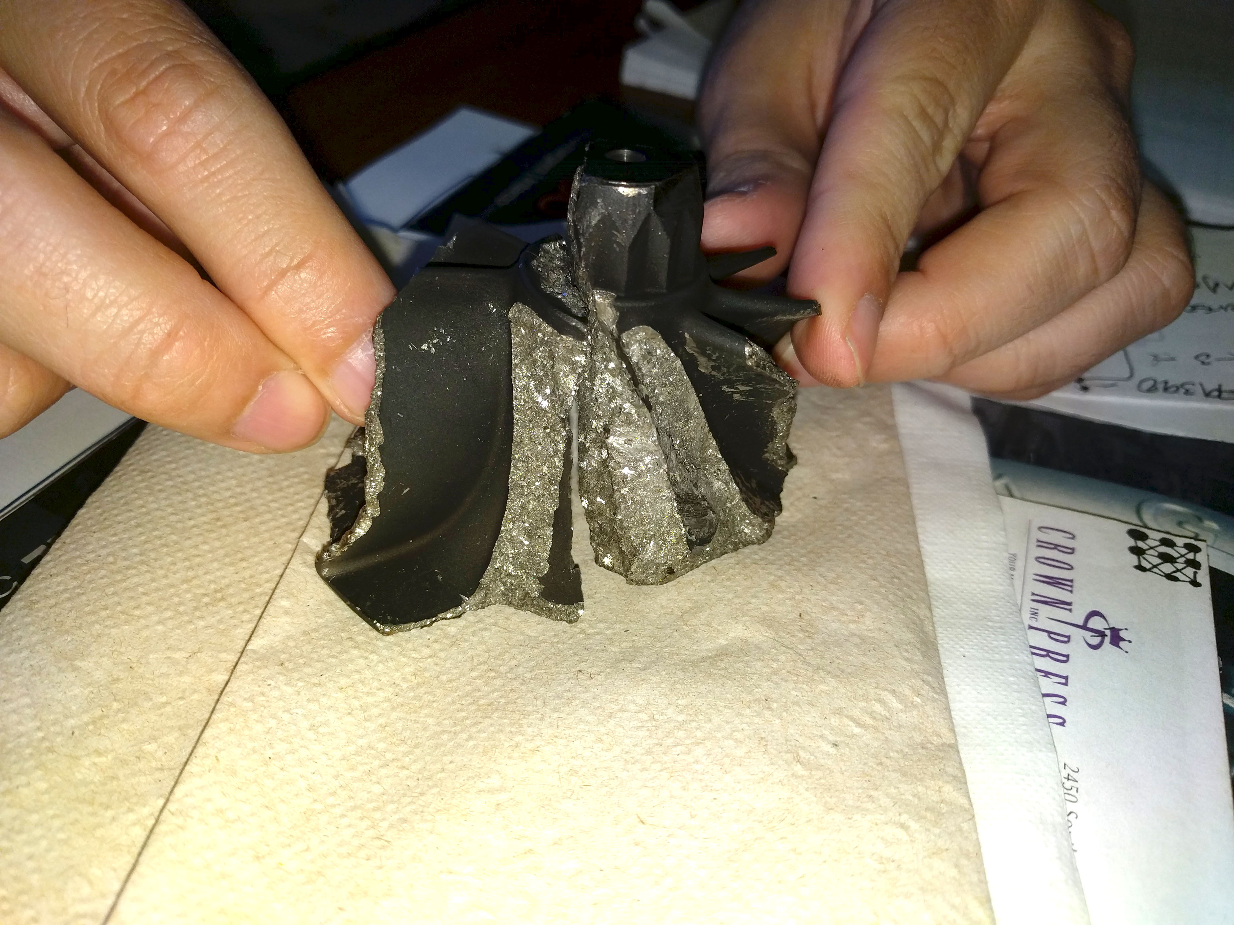

So I felt like this was the tread to post it as a warning to everyone considering a BW turbo.
This is a customer car with an EFR 9180 with a 1.05 AR hotside. This was at 7200rpm @ 38 psi on a Subaru which has the VE of a Ford flathead. According to matchbot it is NOT overspinning.
While I can say turbos do blow up, the problem is that BW's apparently policy is to force a customer to wait for 2-3 months before they decide if they're going to approve your turbo for warranty. Your other option, and this was more of on Full Race's side would sell me a new supercore and exhaust housing at cost and give me a refund once it was approved. Quite frankly, this is absolutely unacceptable. Even with smaller vendors like Comp they don't treat you like a complete pile of garbage.
It blows my mind that the two options are drop another $1500 on a turbo and hope that Borg Warner decides to warranty your paperweight so you get a refund, or wait for 2-3 months until they decide if you're going to have to spend more money or not.
Needless to say, my customer is PISSED and is never going to use a Borg Warner product again. I knew these 9180's could be overspun and grenade but this wasn't. I'm probably pulling the 9174 off my personal car because I don't really want to have it blow up and then be out cash. To be honest, the EFR's make the worst power per mm but do have great transient response, that's about it.

I wonder what went first, the shaft or the wheel. Do you have data logs showing it wasn't overspun? I also wonder if EGT plays a factor in the turbine wheels failing. Having an rpm limit implies that they can only take so much heat as well. I'm sure the rpm limit is established with the wheel at a certain temperature. If its 150* hotter, I'm sure that lower the rpm tolerance.
I can understand your customer being mad, 2-3 months to determine a warranty is really ridiculous. As far as what Full Race is offering, that sounds quite above and beyond on their end.

Just throwing this out there but do you think there might be other factors that contributed to its failure? There are a lot of time attack cars using these same turbos with great results. I feel bad for your customer and shame on BW for taking so long to acknowledge warranty issues.

Eek, I just don't like the look of a cast compressor considering the heat right next to it and rpms involved. Is that standard for turbos of this size or just something to keep costs down?

Black E had an interesting comment somewhere that made perfect sense in relation to the size of the turbine wheel. Basically, the larger size of the wheel on the 9180 made it more susceptible to breakage, compared to the 9174 or even the 8374. I think it's still a bad omen no matter how you look at it and it sucks. I hope my 8374 stays together after seeing this carnage.

You can plug in the information to matchbot. 38psi isn't overspinning it and I've confirmed it with Cam @ Camtuning.
I have no idea what part of it went off first. What I can say is, even turbonetics doesn't have such a dog**** policy on RMA's.

So you didn't actually measure turbine speed. I'm not placing blame here, but I would not run any of these EFR turbos without an actual turbine speed sensor/gauge or some way to log turbine speed. Calculators are great, but the numbers you get out are only as good as the numbers you put in.
Right, and if you have something like a boost leak, 38psi doesn't tell you much. Wheel speed does.
