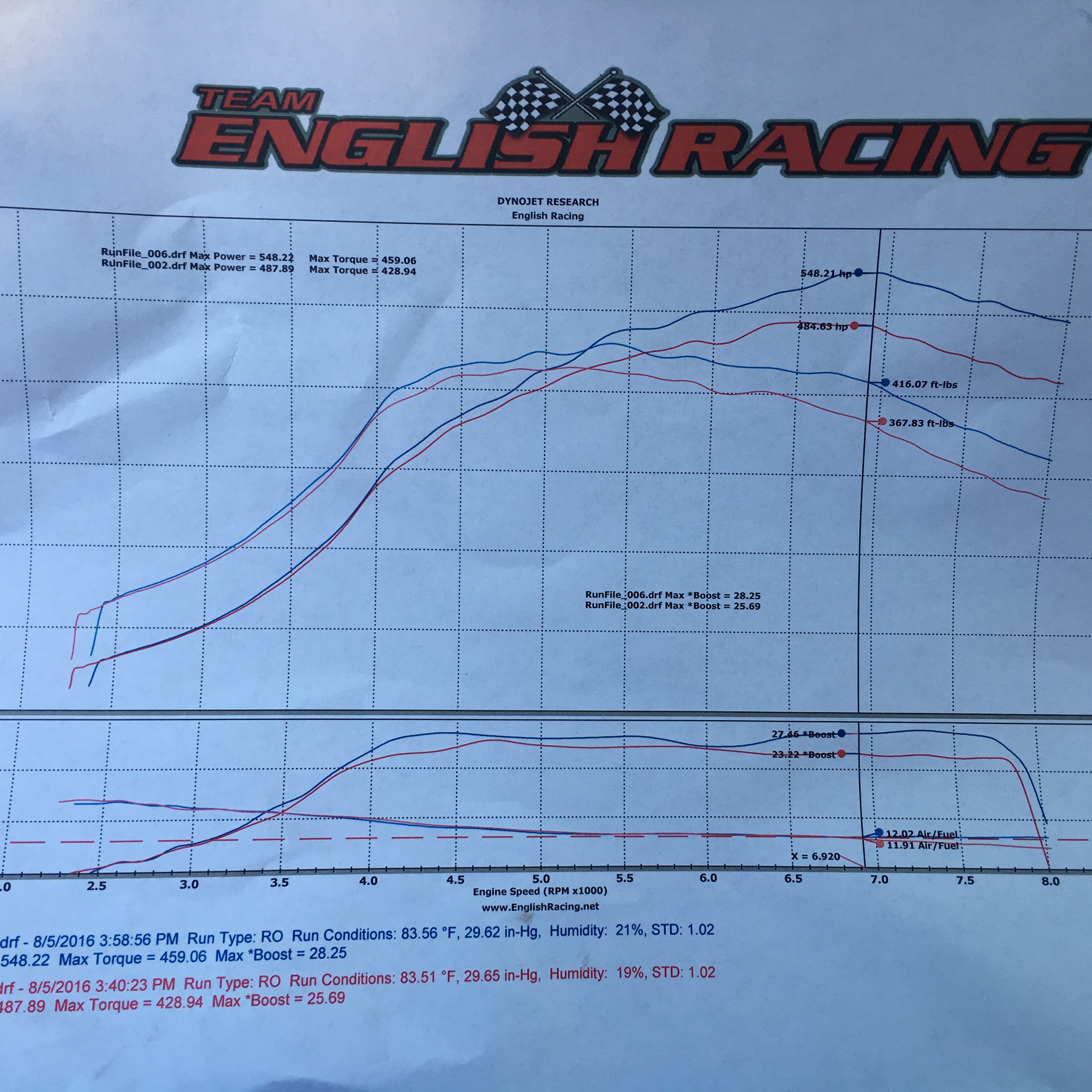

Boost was at 26-27psi

That's nice. You definitely could have made a lot more TQ, but I'm sure you were keeping it reasonable to hold the motor together.
Old Aug 5, 2016 | 09:09 PM
  #4250
Brianawd's Avatar
Posts: 143
From: Portland Or
Not sure Aaron did the tune. He knows I'm fine with pushing the car.
I may do a log and add some timing

Old Aug 10, 2016 | 10:47 PM
  #4257
Brianawd's Avatar
Posts: 143
From: Portland Or
I have to say after just installed a 7163 on my car
And one on a friends X it seems this turbo is a lot of hype.
Don't get me wrong I like the turbo but I don't think it is that
Great. They seem to have big issues with back pressure. They don't spool as
Fast as every one was thinking they would. If I had to do it all over again I'm not
Sure I would do it again. I believe BW needs to look at the design of the turbine housings and make a change

You talk about how they don't spool as fast as you thought but you put a SS manifold on your car so I'm confused as to why you'd do that if quick spool was one of your goals.
Full Race makes a TS manifold for the 7163.
Interesting.
The turbo was aimed at the more track oriented crowd (quick transient response).
Any data to support the back pressure argument?? Also, according to the BW matchbot and MAP, this is a theoretically a 500~520 AWHP turbo max, so considering the fact that you are making almost 50+WHP outside of it's operating range, I am not sure why you are complaining about back pressure and spool . EDIT: I missed the dyno sheet above......
I saw the comments you made in the BW EFR thread. Not knocking your opinion as quiet frankly, you may have had something else in mind when it came to this turbo
Friend just made 482/380 on e85 in his X with the v band open scroll.
I made 548/460 on e85 in my 05 evo 8 with a 2.3L.
The issue with these turbos is the turbine housing
Is causing back pressure issues.
Old Aug 11, 2016 | 05:25 AM
  #4260
RWD4G63's Avatar
Joined: Dec 2012
Posts: 153
Likes: 11
From: Mattawan, MI
Originally Posted by RalliartRsX
Interesting.
Any data to support the back pressure argument?? Also, according to the BW matchbot and MAP, this is a theoretically a 500~520 AWHP turbo max, so considering the fact that you are making almost 50+WHP outside of it's operating range, I am not sure why you are complaining about back pressure and spool . Did you post the dyno graphs elsewhere?/ I saw the comments you made in the BW EFR thread...
To add to this, his car is definitely falling off the cam after 7000rpm. The torque drop is often associated with backpressure. While both affect high rpm power, if you can keep boost flat, you generally are not at the limit of the turbine/housing. I'm not sure this is where his argument stems from, but I thought I'd toss that out there.
