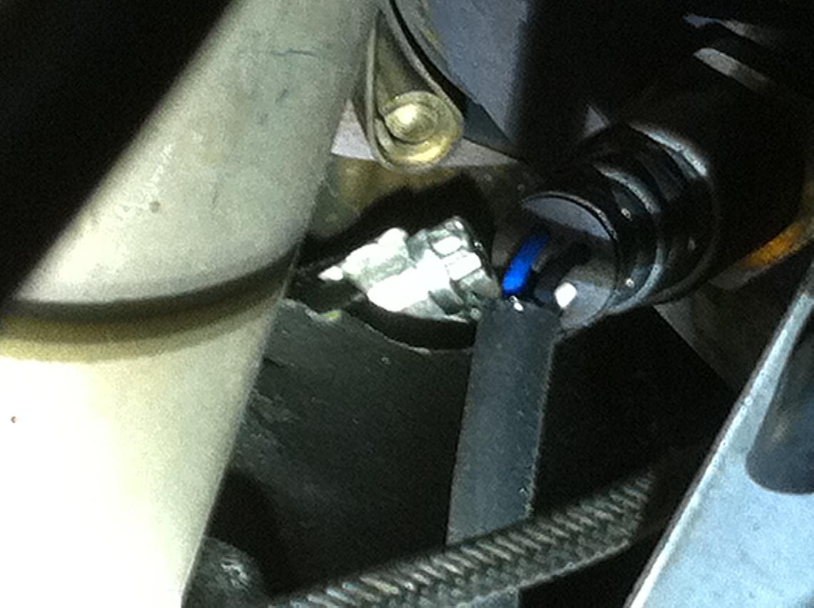

Trying to upload a pic of the block. It is from piston #4. I need help here

Done! But sideways

Originally Posted by vikevo9
Done! But sideways
The pictures you need are of the rod itself, the rod bearings, the cylinder it came out of, what your oil particles and shavings look like when you drain the motor, and similar potential causes of the failure.
The hole in the block is the result, not the cause.
I want you to see the part if the rod that is partially out of the engine.
