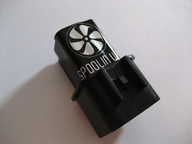

The FIC 2150's are high impedance injectors http://www.fuelinjectorclinic.com/cg...ey=IS226-2150H
They require a resistor pack bypass, something like:
Also, I have FIC 2150's and love them

save your money and get the Fic injectors i run them on my evo but have the ID in my honda they both do there job but one at a higher price your car will run and drive better on thease then any other injector on the market do you like red or blue should be your only choice and you dont have to buy a resister pack bypass you can do this.
https://www.evolutionm.net/forums/ev...istor-box.html

Thanks for your help, If I get with the FIC's can I use this instead of cutting?
http://www.streettunedmotorsports.co...elete_plug.htm

Yes. Pretty much the same thing as the Spoolin Up resistor pack.

No need to cut if you use this.
