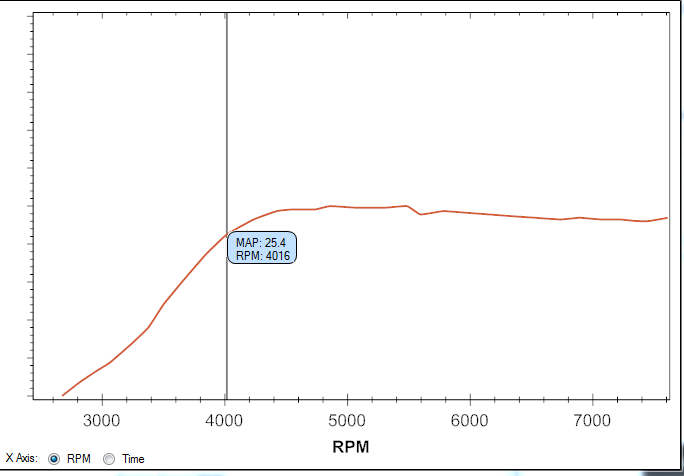

No prob i'll have new results in asap. Hoping to have 25+psi by 4k
Cross posted from my thread... with light preload, I have achieved 25 psi by 4K RPM.
Attachment 334104
https://www.evolutionm.net/forums/10813510-post198.html
