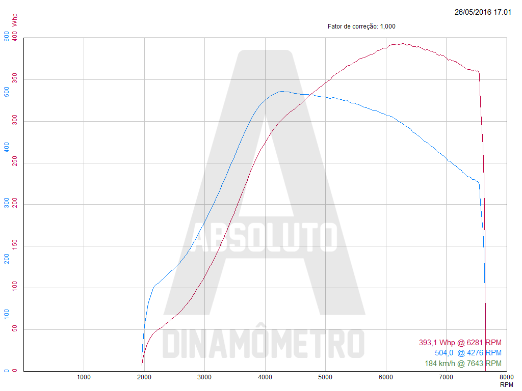

If one were to replace a HKS 7460R that made 393whp@1.6bar on 95oct gas wich would be the best: 1.0XTR or 2.0XTR?
The HKS has an awesome spool and transient response but is unrepairable. Looking for options.

Did your 7460 fail? It appears to me to be made from Mitsubishi parts, you just need to find a place willing to work on it. I read here somewhere that Turbo Labs of America has upgraded HKS turbos with bigger compressors. I also fixed my failed wastegate flapper (need to post a how to) and it's running like a champ.
We fixed it using a MHI turbine housing machined to fit the HKS turbine wheel.
I tried to get the flapper fixed but nobody was sure about what alloy to use on the shaft. I saved the flapper gate and lever to fix it when I get the right info.
