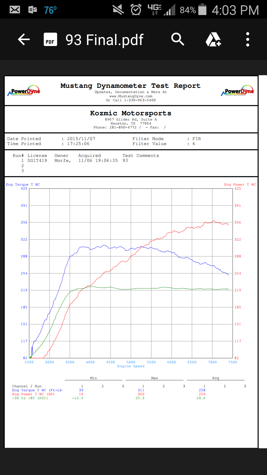

Just catching up. Here's mine
at first, i was like, "hey... those are stock IX turbo numbers"... then i saw it was a Mustang dyno LOL.
i'd be more than happy with those numbers. i really like how fast these things spool up. i should have some numbers by the end of this week. i'll start tuning the boost curve tonight. timing and AFRs are mostly spot on, at the moment.
Mustang dyno, like you said, and 26psi..lol. A 9 turbo would need to be cranked up to a ~30psi spike tapering to 22-23 to make those numbers on a dynojet...lol
The curve goes upward from 6000 rpms too

Damn, I wish I had access to 93.
350whp Dynojet was my goal. Maybe not LOL

It'll do 350whp on 91 on a dynojet. I did 350whp on VD with GSC S2's, the ETS 3.5" intercooler, and a 9 turbo at 25psi tapering to 18psi..

Maybe. But I only have a mild 264 cam, LICP, TBE, and a cone filter. That's about it for power mods.

Get an intercooler. I'm sure you'll be right there..
