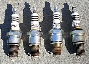

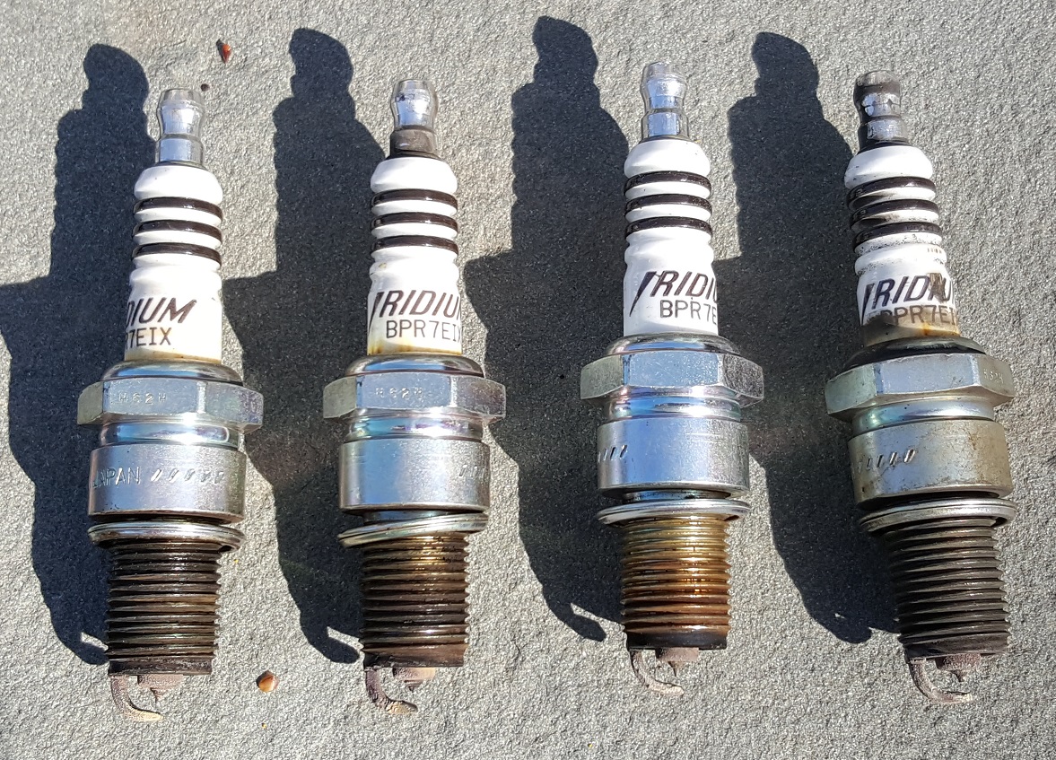

Well it was the plugs.
Replaced all four. Right side plug (not sure if that's 1 or 4) was also loose, not so loose that it came up with the plug wire, but I hand-unthreaded it without the wrench.
See pic of the plugs.
Drove it hard this morning and wow, what a difference.
Thanks for the help and I now know not to use the Torque app as a boost gauge as well!
Anthony

These were likely changed at 50k. So 35k of wear on them. I lost my notebook where I used to keep these things (now they are on Google Docs), but my maintenance log doesn't go back that far.

Yea, those things were done. Lots of erosion on the electrode.
