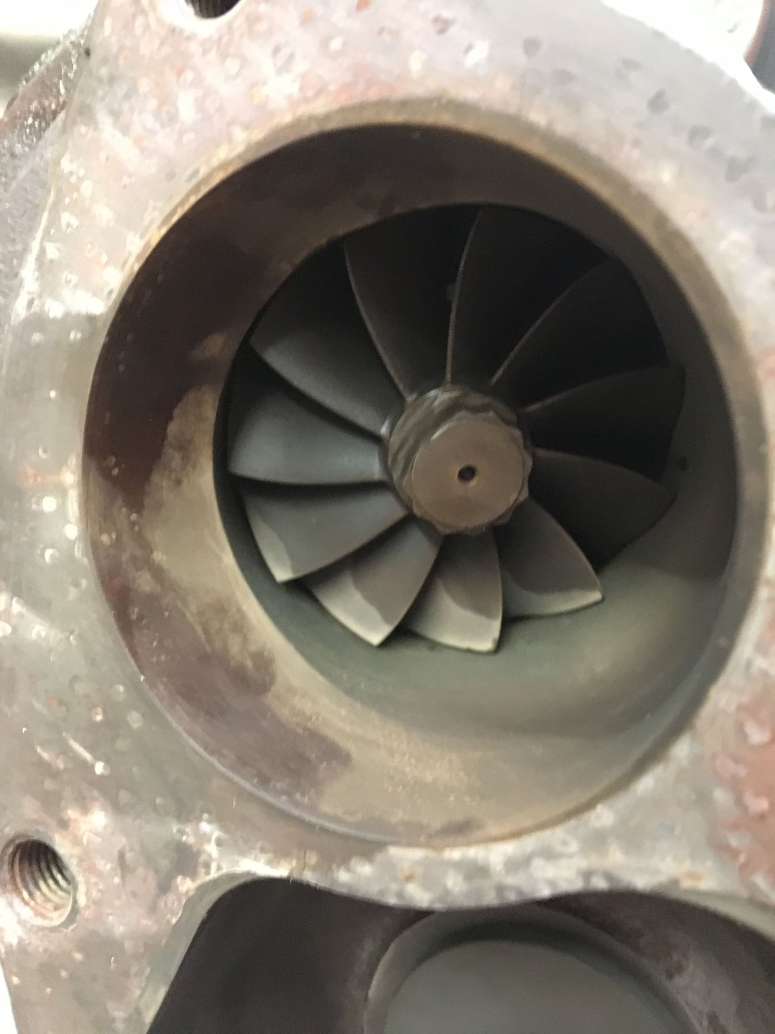

Got the turbo off to send to FP. Couple pics

Where's the oil ?

Originally Posted by RightSaid fred
Where's the oil ?
Compressor blade is coated as you should be able to see and there's oil all right behind the turbine..?
