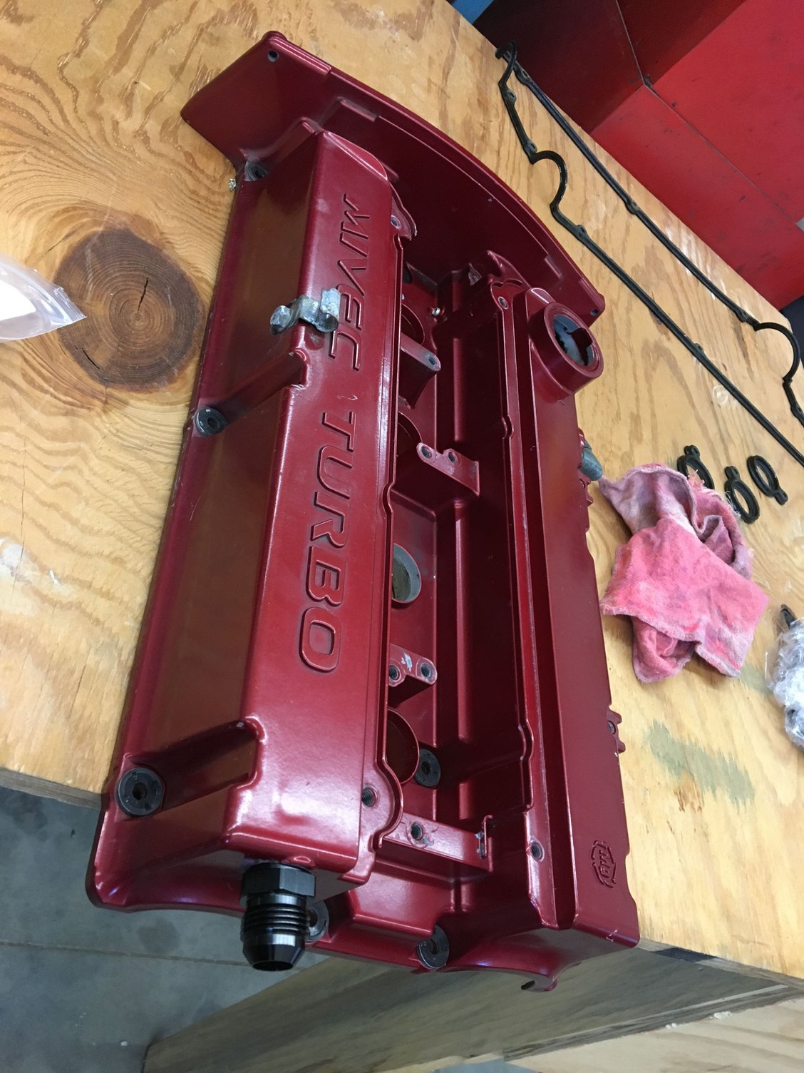

Thanks Tom @ TSComptuned for doing the VC. Ets kit will be here tuesday

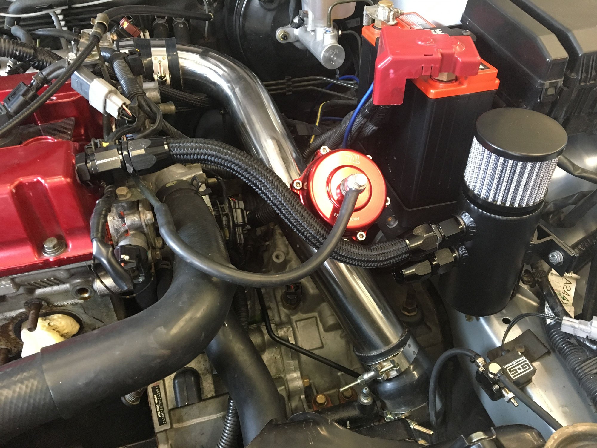

Hoping this place will work for my catch can setup. Of course the tial bov has to be in the middle of the uicp and not closer to the TB... just how it works out for me.

Well. Everything is installed and running good. I don't believe it is smoking. Only driven it once but I'm pretty sure the issue is taken care of.

Do yourself a favor and give it a rest. The problem was he didn't have a restrictor in his oil line, to much oil to the turbo period end of story
