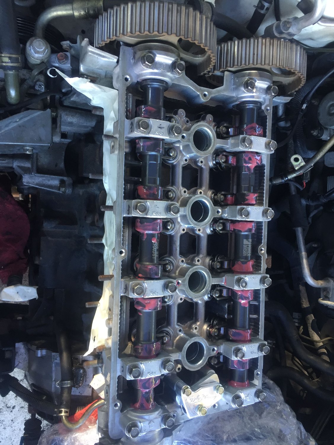

Are you installing ARP head studs?

Yes already did. Stopped there and today lifters, cams, manifolds etc. Yeah I ask because I figured it would be a pita keeping them with the dowel facing up as they go in.
were you able to "finger tighten" all your head studs?
Make sure every lifter are able to hold pressure (to verify internal check valves don't leak). Cams go in easily by torquing down cam caps in a pattern and go through 3 or 4 cycles in even step increments. Setting timing belt is the pita. Lol
Be patient
Also, when installing manifolds, pay attention for me to see how the ports line up. I'm curious if holes line up centered or if the manifolds hang lowered (there is 0.04" difference in diameter between head and manifold). Thanks.

I’ll check. I ordered itm lifters so I’ll bleed them and get them in.

What about your rocker arms? I soaked all my lifters and rocker arms in cleaning fluid. Then I drained and dried the parts while keeping track which piece came from where. I put them all back in same positions just in case there were slight seating angles (wear on moving parts). Before installing, I filled and flush/bled lifters with new synthetic oil and used assembly lube inside the entire roller bearing of each rocker arm. Assembly lube is thick, so roller bearings didn't spin easily, but that's fine with me since I don't know how long it would take before oil gets inside. Besides my GSC 5041 will put extra pressure on these bearings and I didn't want bearing to be dry. Take your time and pamper your baby.

Oh I put everything back in the exact same spot.
Now comes the fun part. Timing. Here goes nothing lol.
