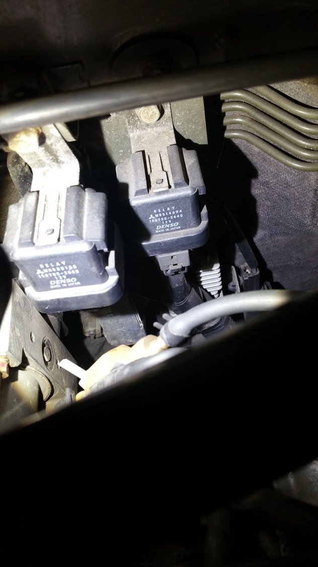

Try pulling off your fuel pump relay #3. It's possible that your relay is failing and giving full power.
Old Mar 19, 2018 | 09:29 PM
  #115
2006EvoIXer's Avatar
Joined: Jul 2012
Posts: 3,294
Likes: 197
From: California
By pulling relay, your fuel pump will only get 8V
