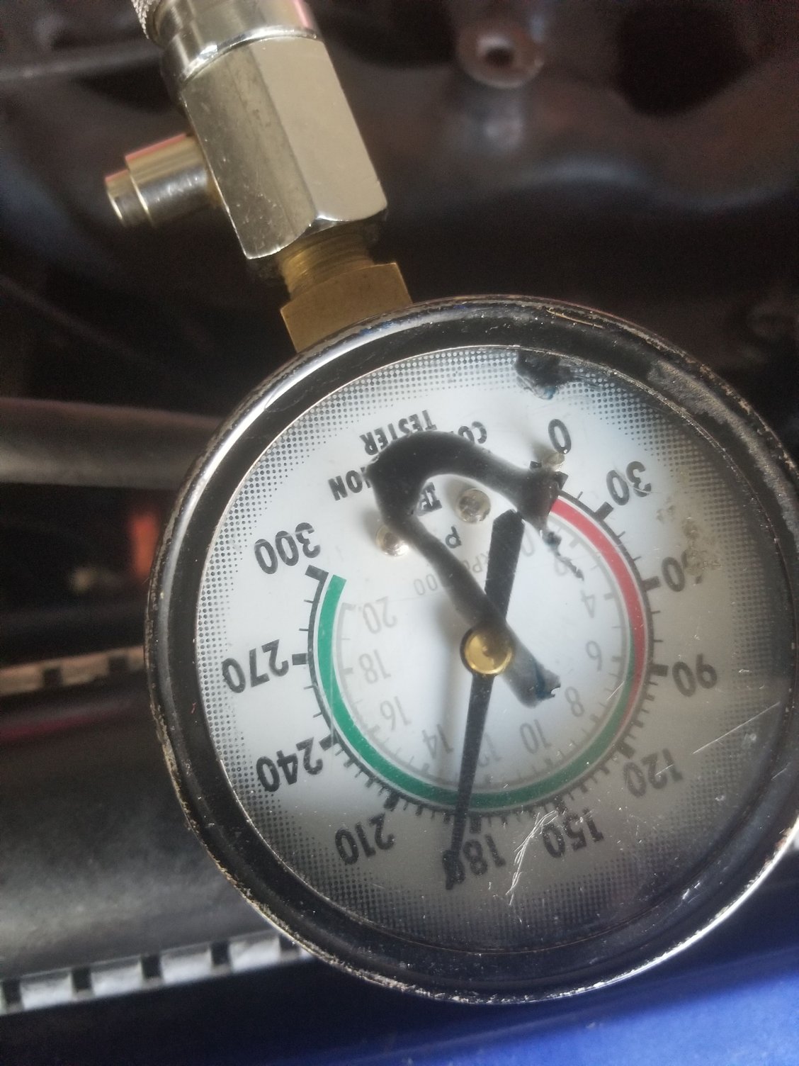

Old Jun 1, 2019 | 12:18 AM
  #112
MR ArcticC's Avatar
Joined: Sep 2011
Posts: 126
From: Finland
Great to see there weren't any damaged valves and the compression is fine
