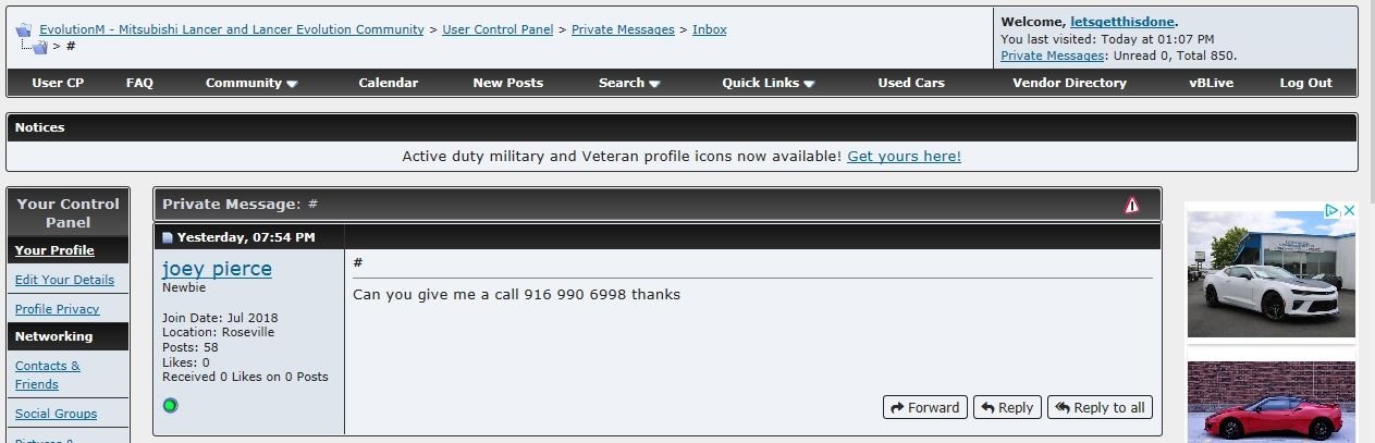

There's been plenty of things discussed here that you haven't investigated. You keep asking about the timing when we've said it's correct about 37 times.
It's interesting that you asked me to call you even though its fairly apparent you're not here to list to what we have to say.
