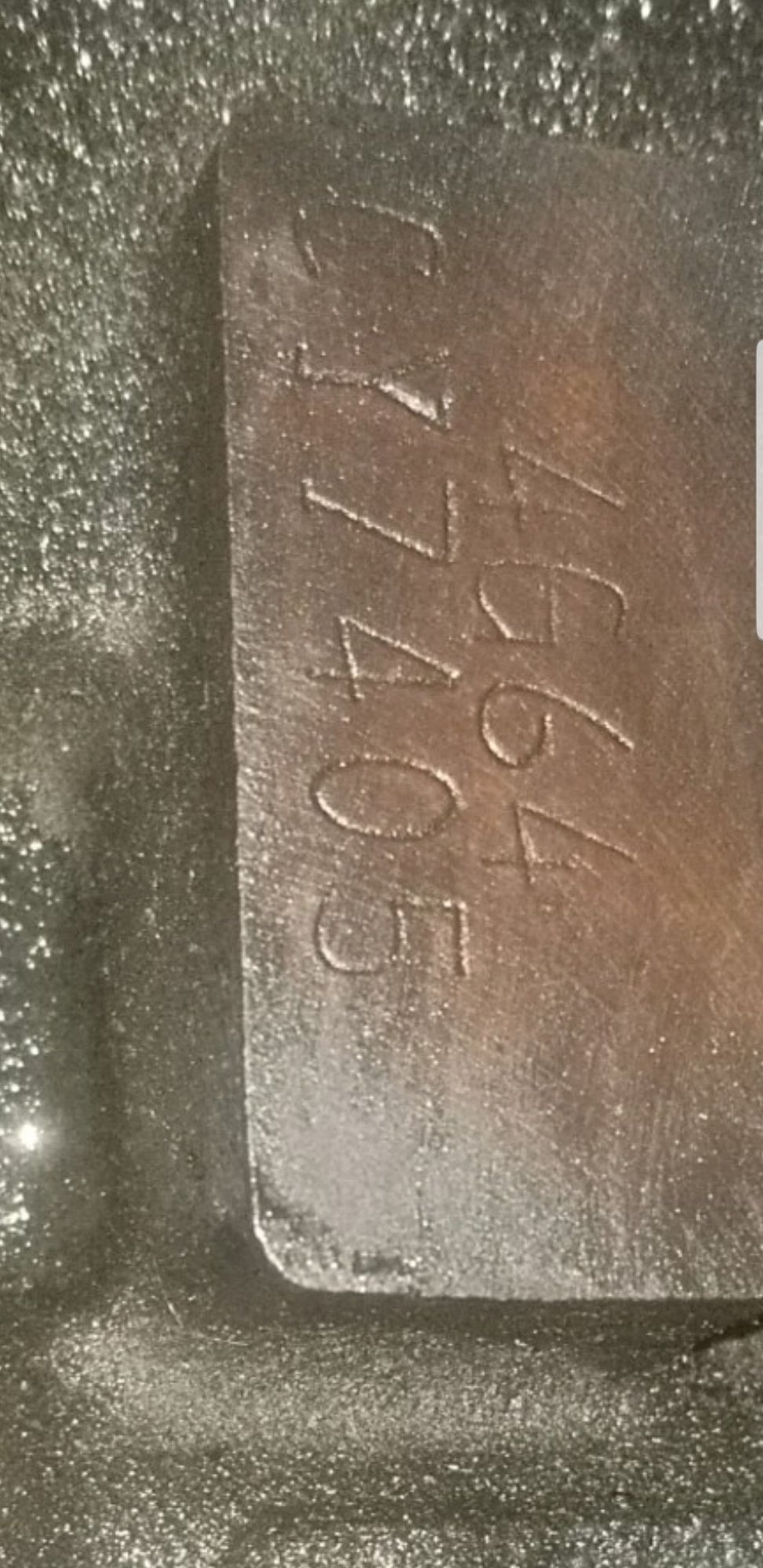

Trying to give as much info as possible. Heres code for my block
