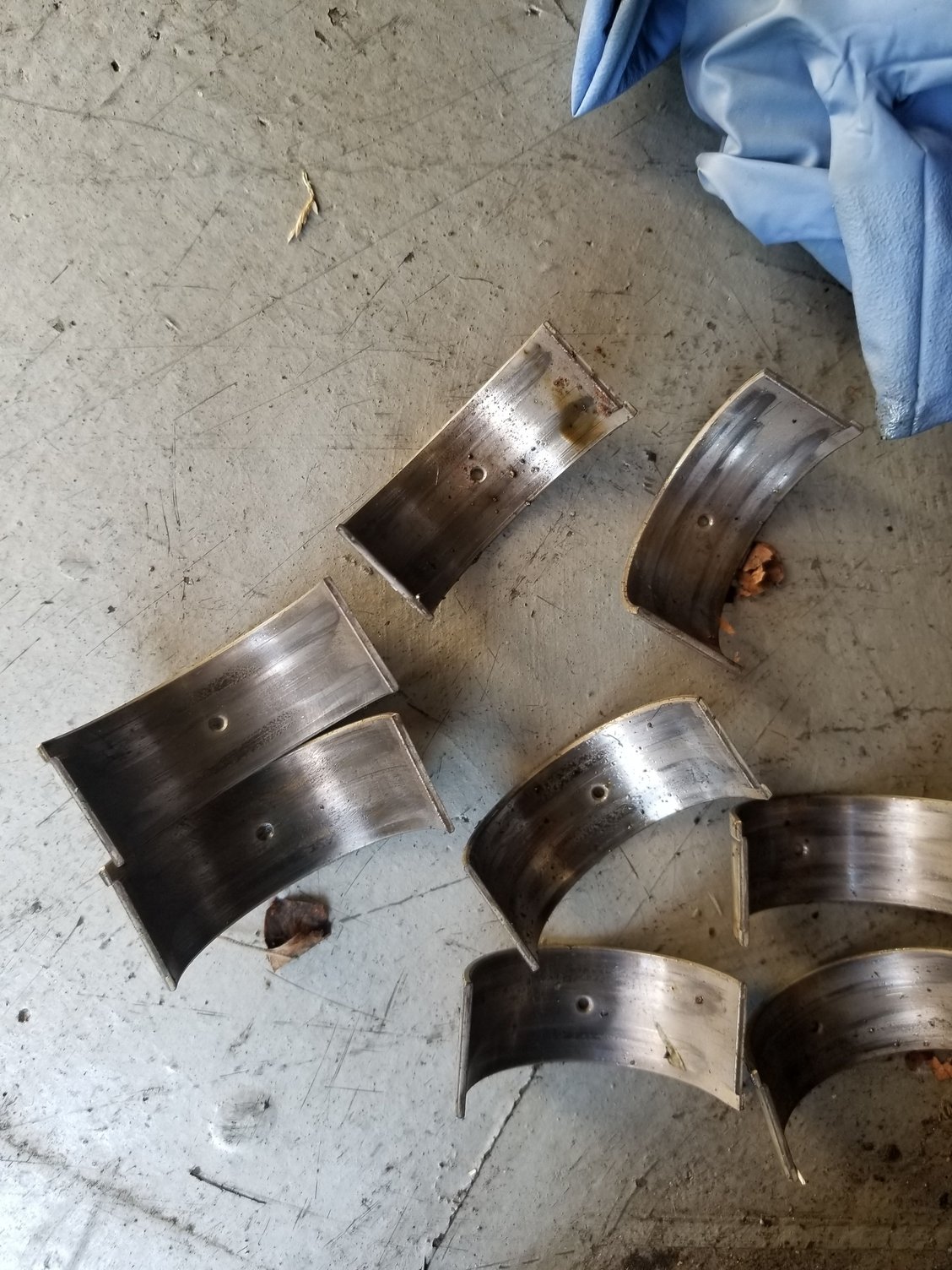

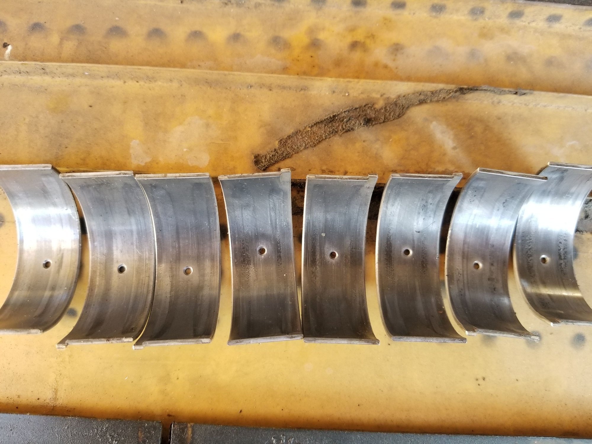

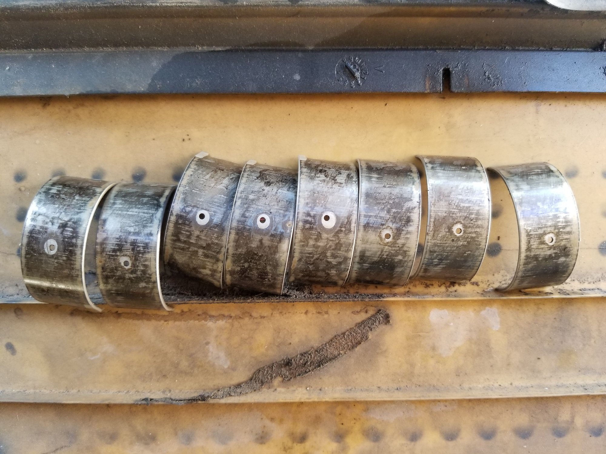

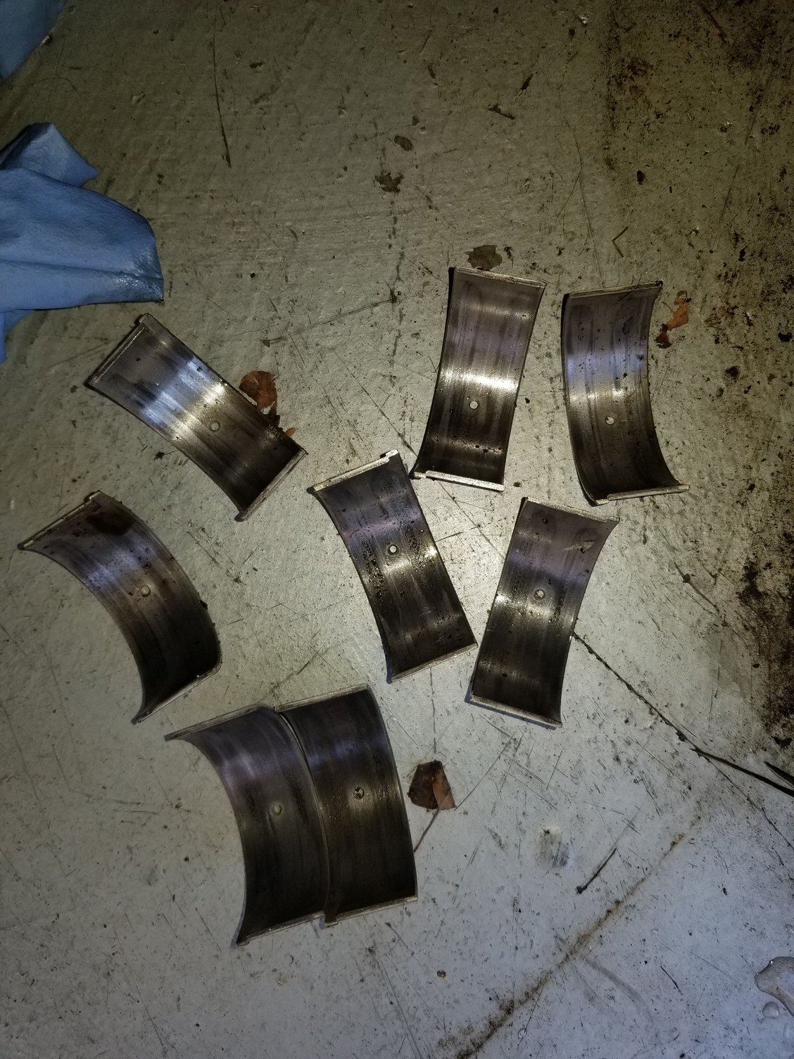

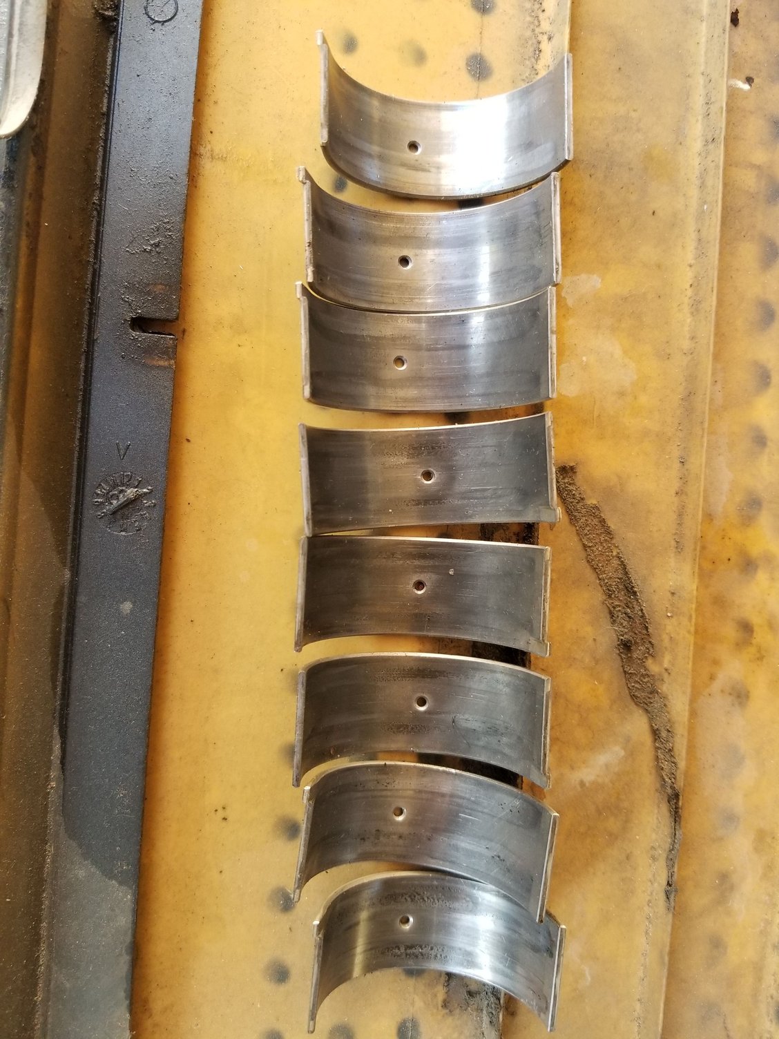

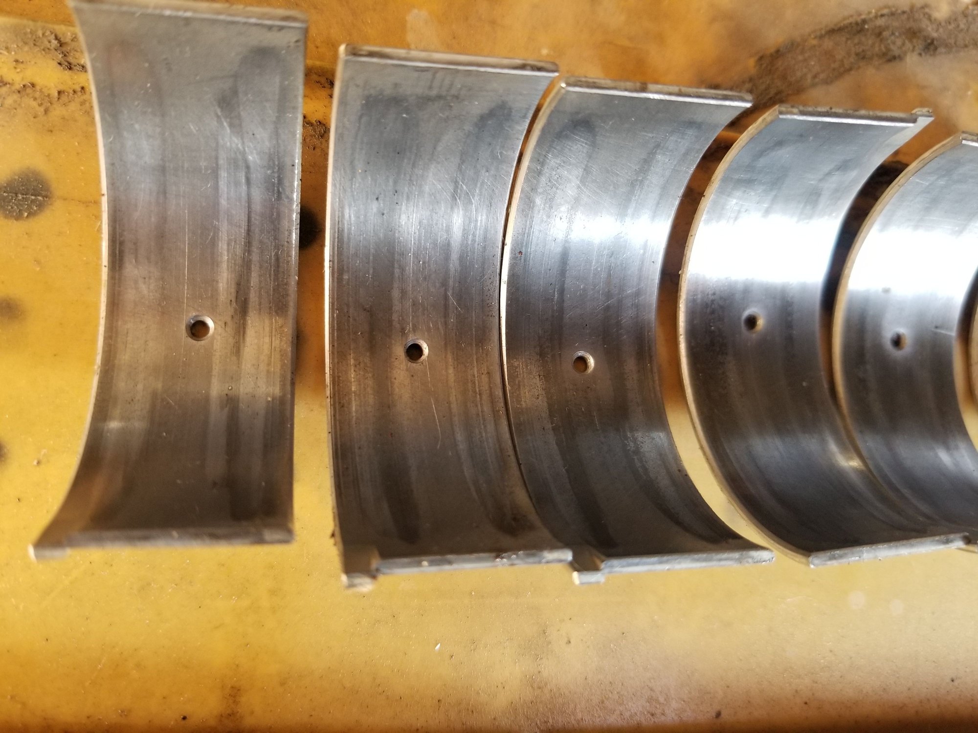

Old Sep 23, 2019 | 02:29 PM
overdrive1's Avatar
iTrader: (23)
Joined: Jun 2008
Posts: 165
From: Toronto / Albany
Originally Posted by 2006EvoIXer
Can you post up pics of your old rod bearings?
Pics attached
