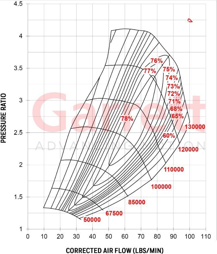

This just posted on the Garrett Facebook page. Audi TT with the 2.5L, G35-1050, looks like 0.83 A/R. 975WHP ain't shabby.
They were over-spinning it a bit... I marked roughly where they were operating. I'd eyeball it at around 145k rpm and ~73% efficiency.
that thing must be a monster! I have seen rs3 running about 600 whp hit high 9’s in the 1/4 , so that TT must be crazy!

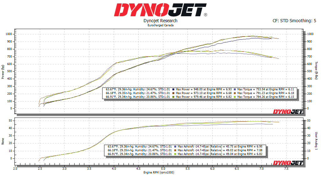

600lb/ft of torque from 4K to 7.5K is no joke. Almost 800lb/ft peak. Even with DynoJet numbers, that's huge.

DynoJet means those are real, repeatable numbers and the car will trap an appropriate mph based on them.

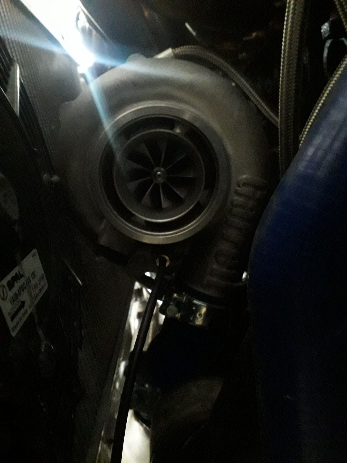

Going in the car over the next few days. Hopefully first fire up on Sunday this weekend.

Is that a 3.5 dp or just a 3?
Old Apr 20, 2020 | 09:02 PM
  #160
LetsGetThisDone's Avatar
Joined: Oct 2013
Posts: 15,973
Likes: 1,629
3"
3.5 isn't even really needed at 900whp. Let alone 650.

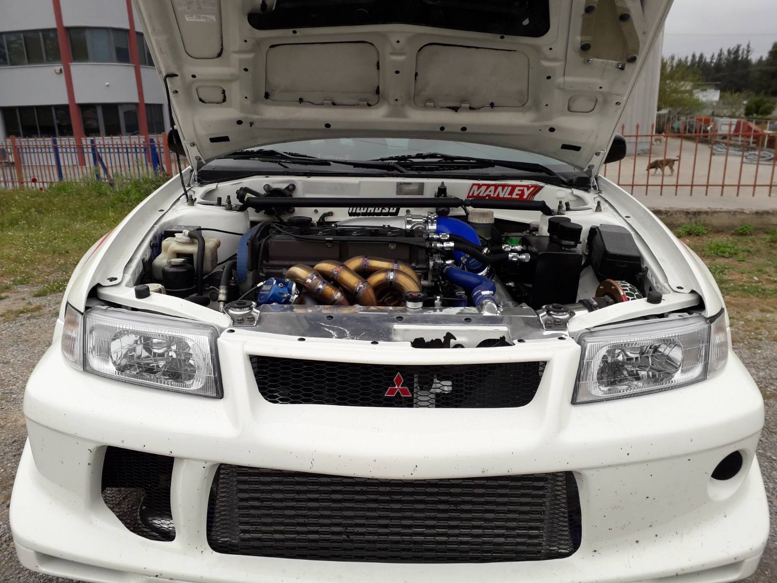

As this is my first post I would like to say hi to everybody.
Last week we finished the instalation of a G30 770 with 0.83 on my Evo 6.
The car has a fully forged 2.0 LR engine with oversized valves, 278/274 hks cams and a hand made intake plenum.
Moving from a Gtx3582r to G turbo have to say that feels like day and night. Massive response and instant torque.
Due to Corona virus restrictions we haven't managed to Dyno tune the car yet but only with some street tuning and 1.5bar car feels a lot faster.
Full boost is just before 4500rpm and keeps the power all the way up to 8500rpm.
Of course the Dyno will show all the truth but as of now full boost have dropped by almost 1000rpm and Dyno butt is feeling very fast.

Thanks for posting up! Can't wait to the dyno results.
I'd also like more info on that intake manifold.
