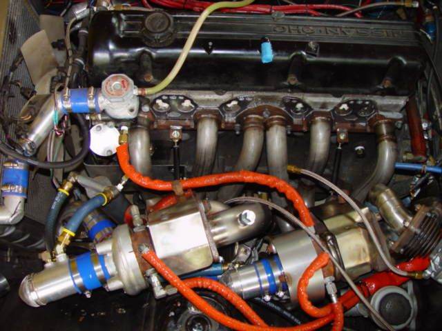

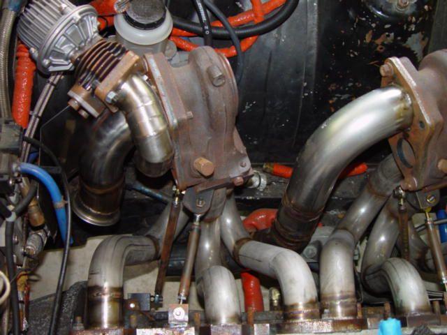

A pair of TD05 16g's on my 240Z....May 2003. I would not run a solid bracket on a tubular header because they need to move around so probably best to use heim joints like I did below. For the thick walled stuff everyone uses these days I don't think bracing is necessary, but can't hurt as long as the manifold can move around.
