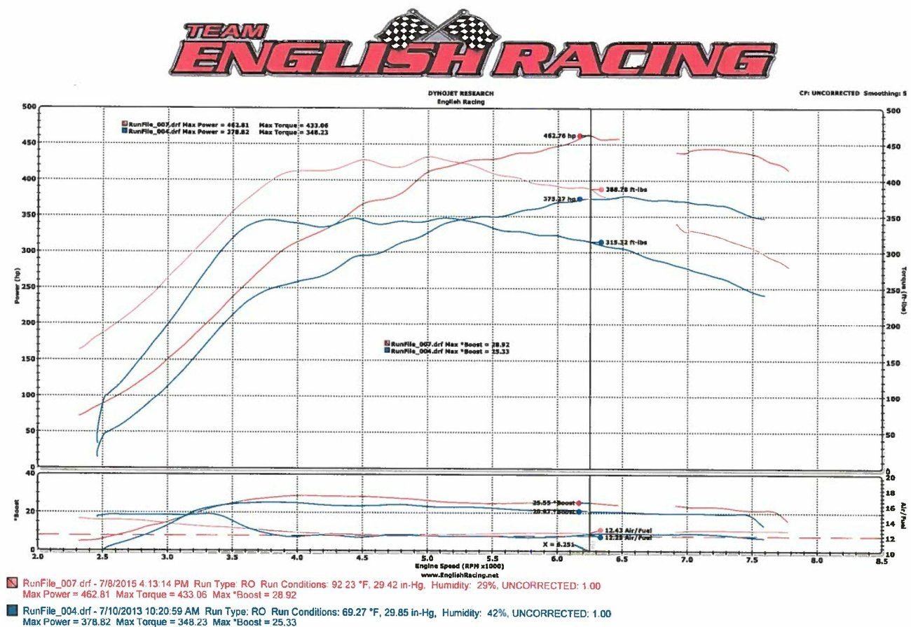

What's the spool like on the BBK Full BB?

This was from 2015 and just a baseline tune on the old 2.3l. We had issues with the plugs and breaking up a bit up top and just ran a flat duty cycle with boost dropping past 5500. Now its on the 2.2 and holding more boost but I just tune it myself from logs while racing and havent been back to the dyno since.

damn, that's some nice spool

advantages of a big motor. I'm jealous LOL

Truth! 400 lb ft by 3700-3800 is respectable . We've got an engine that can only consume so much air (down low) and will go to 7500-8000 proud with an MHI housing.
Regarding the bbk full, IIRC its a 550whp turbo that tapers a bit after 6500-7000.
