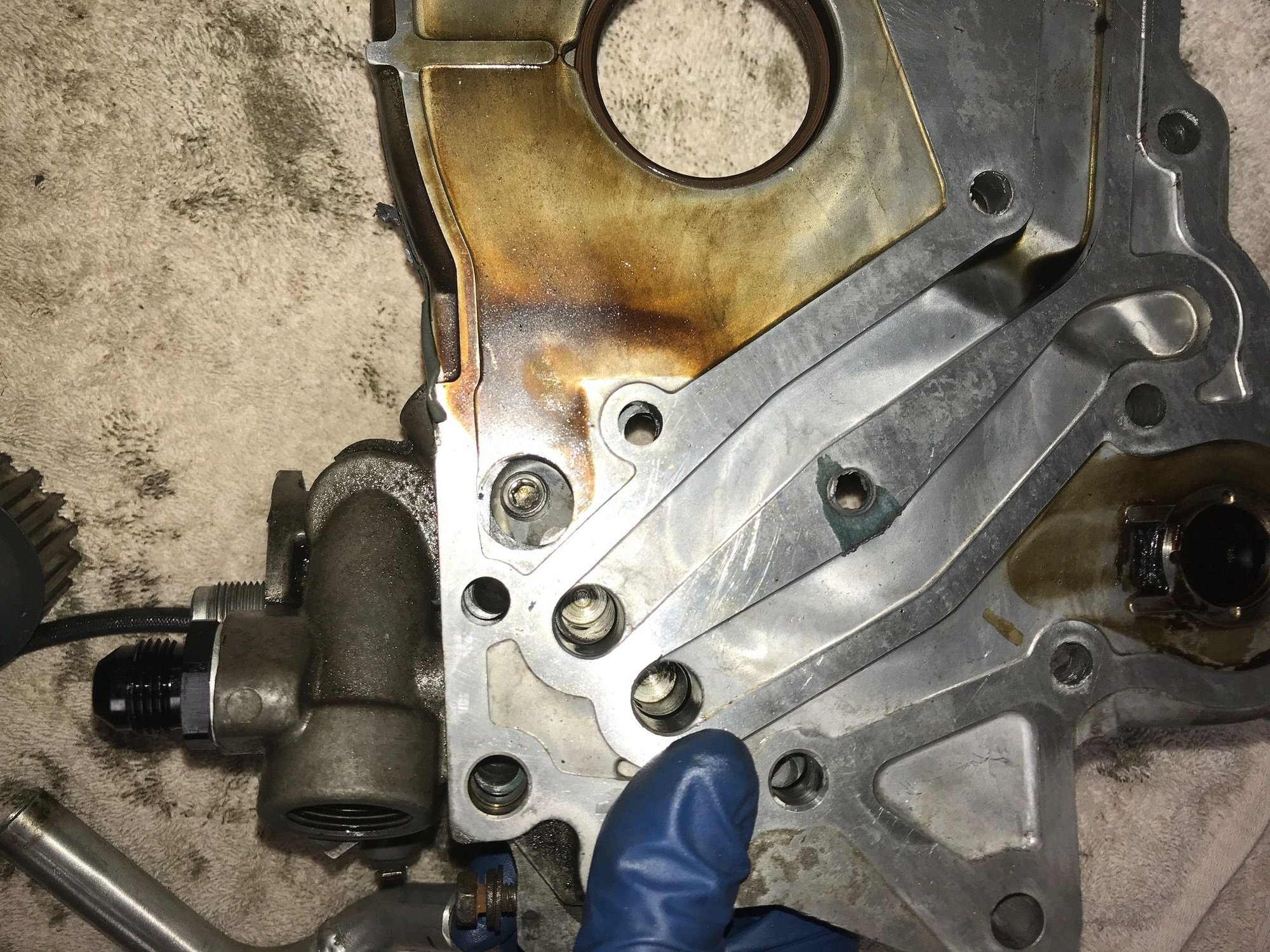

How did you block off the factory oil pressure relief passage to the block in the oil filter housing?
Old Jul 6, 2020 | 01:48 PM
  #38
240Z TwinTurbo's Avatar
iTrader: (25)
Posts: 2,810
Likes: 329
From: Charlotte, NC
Nevermind, I just tapped it 1/8" NPT. I guess I am committed at this point since I just ordered everything!

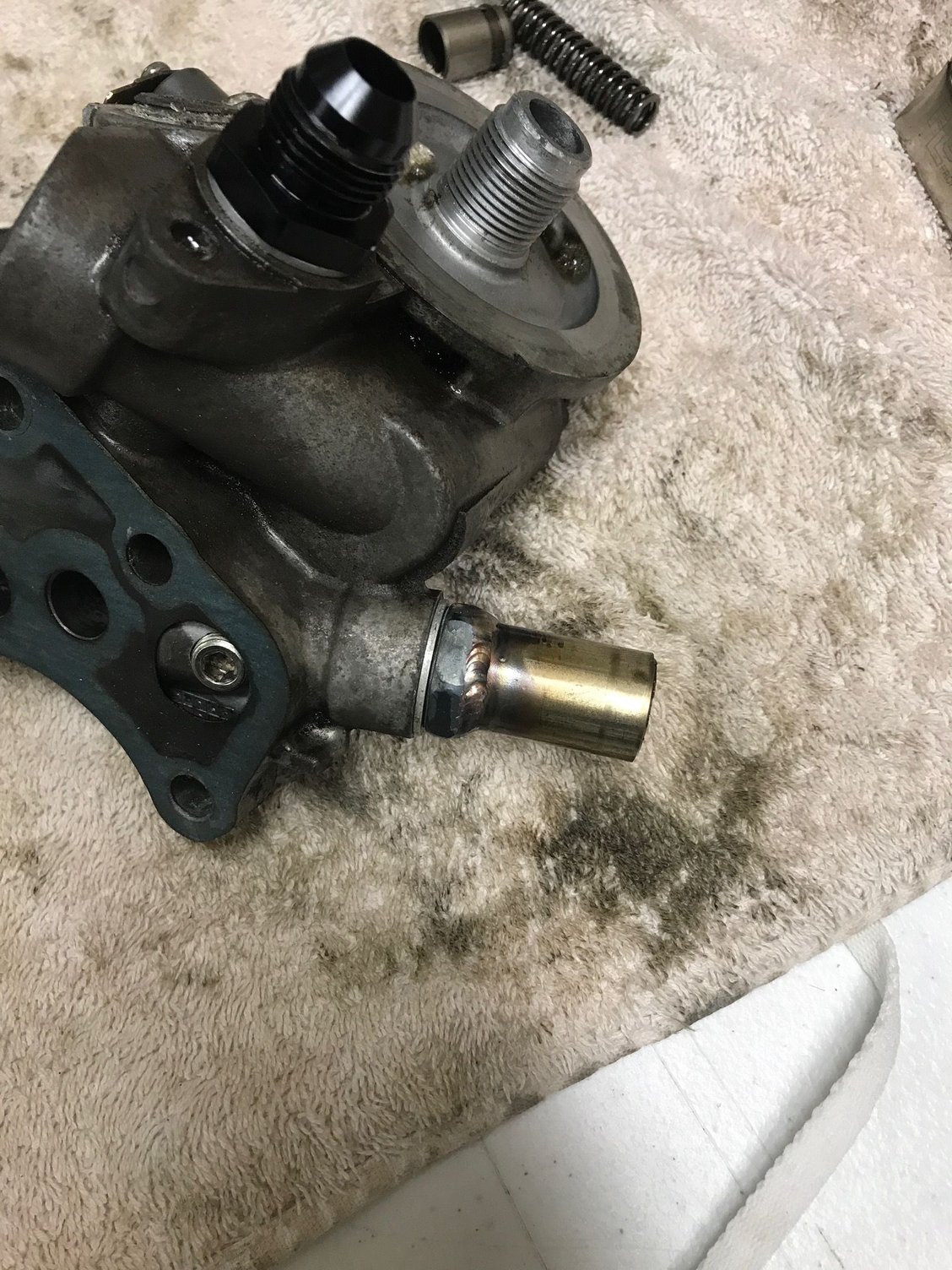

I drilled a hole in the factory cap and then welded a piece of stainless tubing to it and will next weld on a -10an fitting on the end of the tube. Should have the weld on fittings Wednesday.

Yep, went with the Aviaid regulator since the one you used was on back order. The also had the kind that mount to the pan you mentioned and seal with an oring, but I decided that was not for me and went with the AN fittings.
https://aviaid.com/shopsite_sc/store/html/remot-reg.htm
In hindsight I should have just put this in between the oil filter housing and the oil cooler instead of welding the fitting to the oil bypass spring cap, but it works just the same either way.
