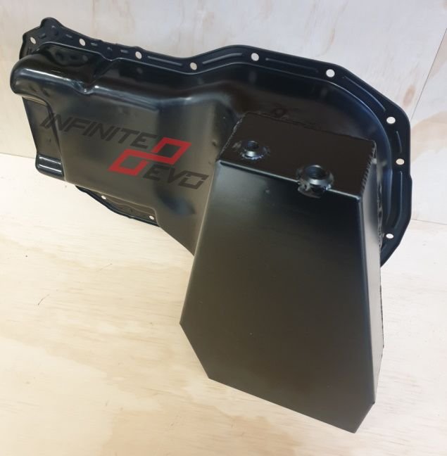

Hey @MuslimEvoFreak , check out some pics of our Prototype #2.
I changed the design a bit, so this is currently on my car being tested (when I can with Covid Lockdowns).
Everything is looking really good, I just want to hit the track to verify some of the changes.
InfiniteEvo new oil pressure regulator, fresh ground-up design

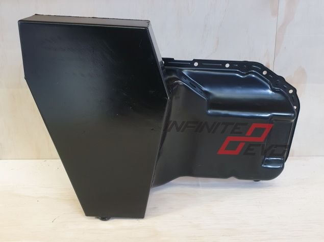

Nice
What is the oil pan capacity after this mod?
Old Sep 19, 2021 | 12:36 PM
  #83
Grimgrak's Avatar
Joined: Dec 2011
Posts: 1,622
Likes: 17
From: Panama
My guess is 7L
Old Mar 3, 2022 | 10:37 AM
  #84
RSMike's Avatar
Joined: Jul 2009
Posts: 2,276
Likes: 372
From: New Zealand
Originally Posted by Grimgrak
My guess is 7L
1.5L above factory capacity

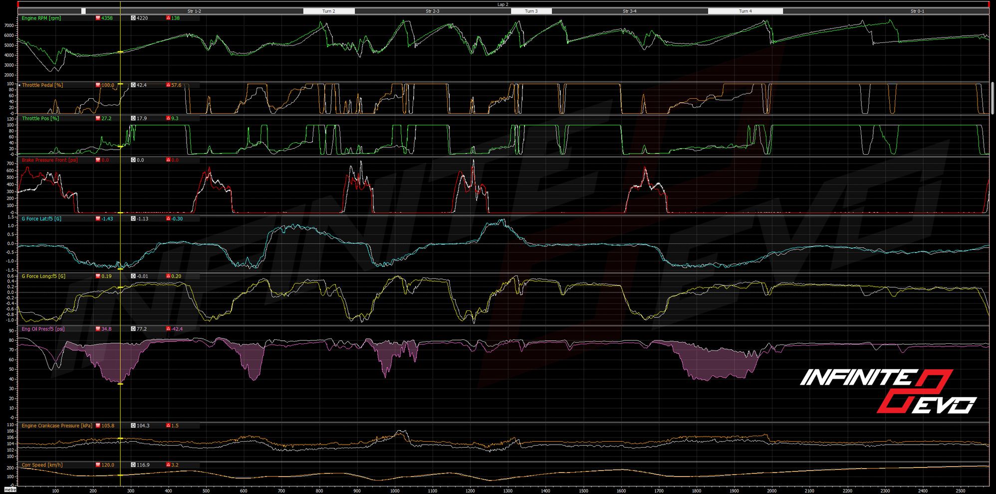

Finally - we have data from the same car, same driver, same oil, same conditions etc.
A true back-to-back test with all things being equal.
The new Infinite Evo oil pan for Evo 4-9 massively outperforms the current "leading competitor".
Sales will be up very soon, production is in full swing.
Pink section is the difference of oil pressure between the Infinite Evo oil pan and the competitor

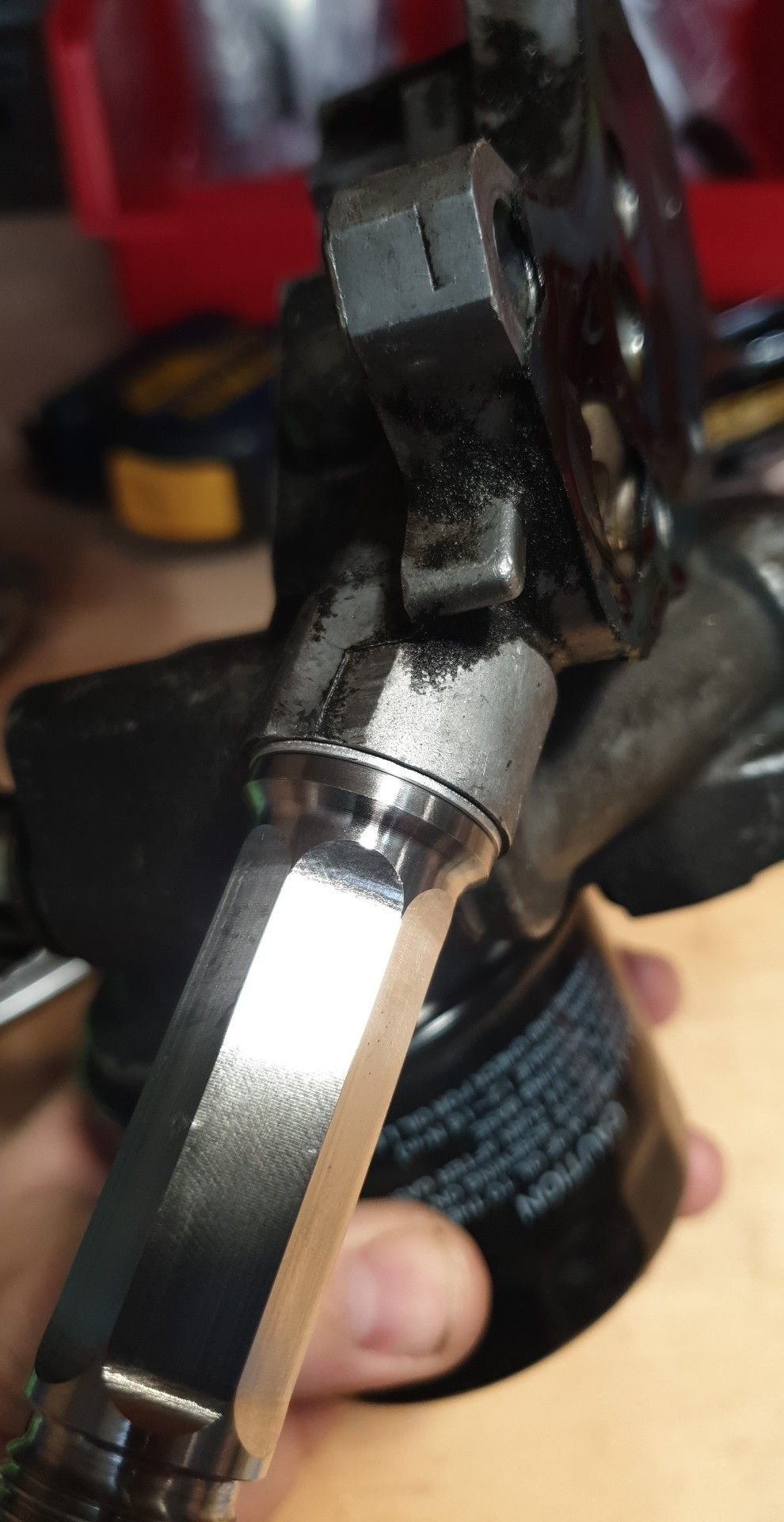

@RSMike is this required when fitting your sump kit?
Hey @EvocentriK , you dont need to modify the housing when you're installing our kit.
It comes with all the parts you need, except for silicone/sealant for the pan (I'll look at add that once I have supply of sealant).
Our oil filter housing fitting replaces the regulator parts.

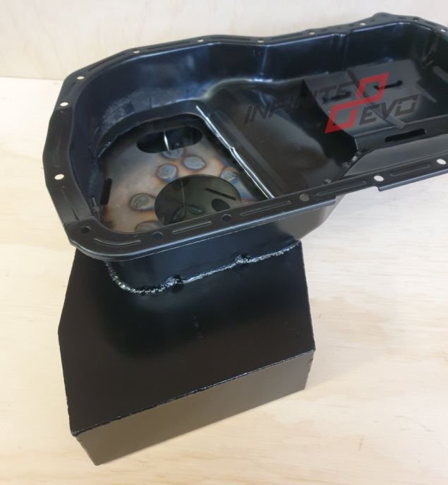

Thanks for that. So if the stock oil return hole is unplugged, does oil continue to return to the back of the pan in the stock location as well as via the new front of pan return system?
Also I asked this elsewhere but I'll put it here to consolidate - the pans stocked by Benny at Benchmark all have additional NPT ports next to the oil drains. I don't need this, I have an oil temp/pressure sensor in the housing already. Are the pans available without these additional ports?
