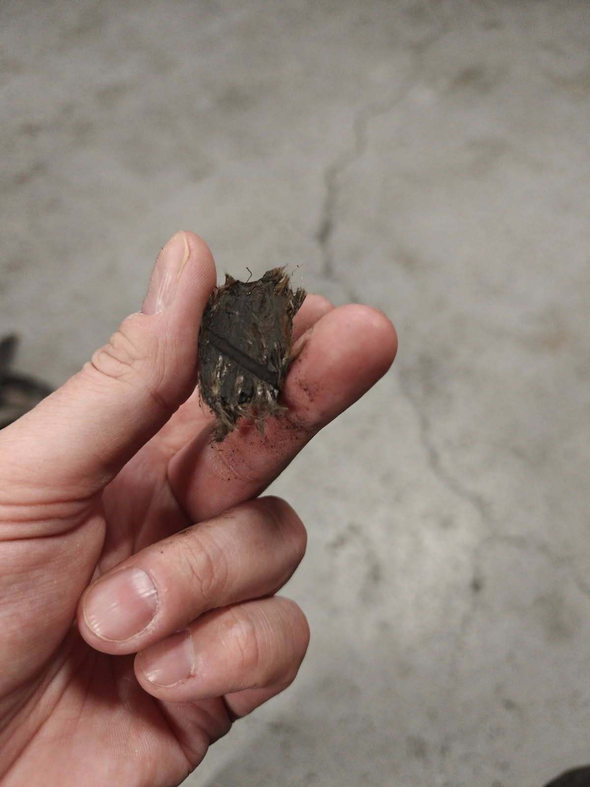

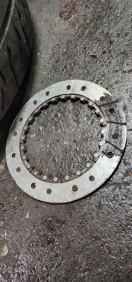

So shop took my car apart yet again, found no fluids anywhere my clutch and found this.
Not going to say something didn't get on the discs, but main seal was dry and so was t case
