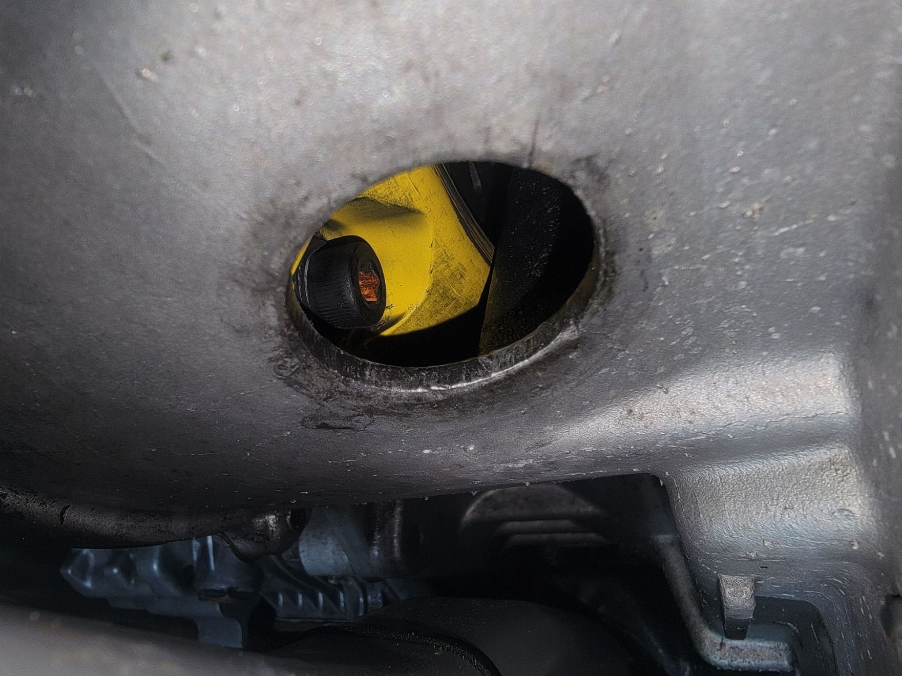

I believe the clutch fork is cast, and for some reason my brain can't comprehend why cast parts would bend. Ive been in the game for 18 years and have never seen a clutch fork bend. Friction areas have worn out but never a bend.
One thing I discovered that created HUGE issues for me was that the restrictor pill was still in my slave. This was 100% my fault, I bought a brand new OEM Slave after being on a QM 8 Leg for 10 years and never realized I needed to remove it. This is what I believe led to my premature failure on the organic discs, although from people's experiences I already know they werent lasting long either way. This also doesnt remedy all of the known failures between the anti rattle springs/the dowels/the rubbing etc. But it may help with adjustment effectiveness.
TLDR: Make sure theres no restrictor pill in your slave cylinder
Old May 22, 2026 | 01:54 PM
  #389
ViciousLSD's Avatar
Joined: Oct 2011
Posts: 3,858
Likes: 600
From: Houston
I was thinking shift forks but I have read of a few broken clutch forks, maybe a hairline crack make it look bent.
https://www.reddit.com/r/MitsubishiE...ken_like_this/
crack on the pivot for example would make it operate like its bent.
Definitely something is off. I personally never had issues finding the sweet spot. If there is a clutch master or slave cyl upgrade in the past, maybe a rod was too short?
