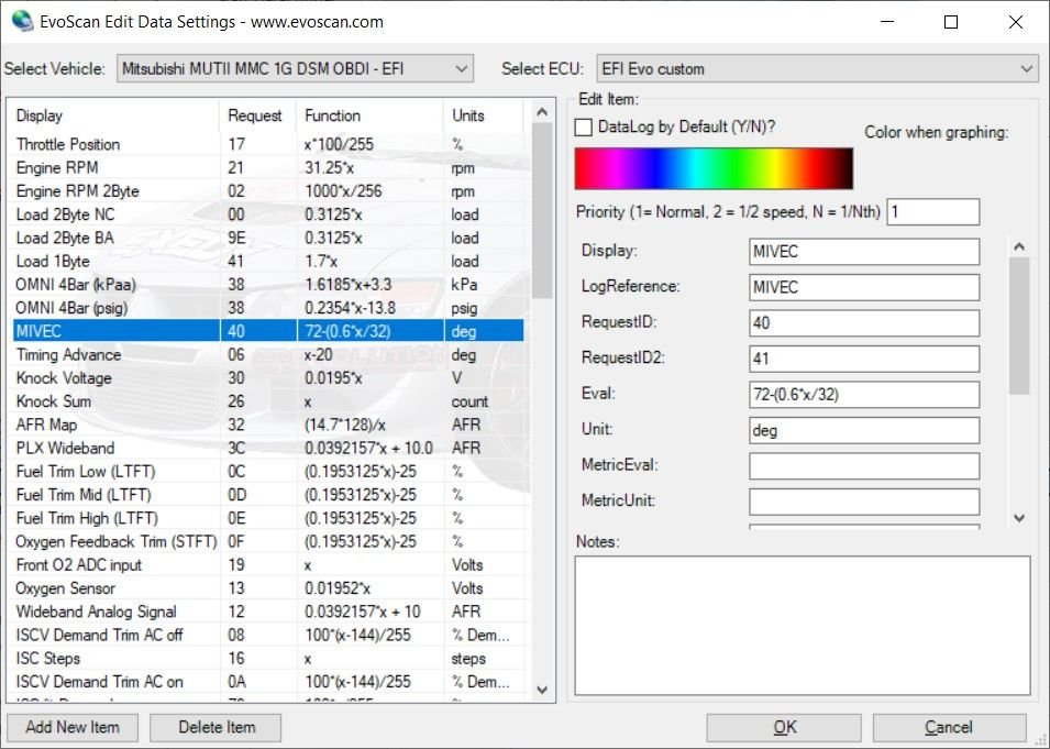

I have a few datalogs with timing advance and MIVEC datalogged. Would that help? Not sure what I should be selecting in EvoScan re: cam position desired vs actual. Should I compare the timing advance in the datalog (actual) to the tune xml (desired)?
It doesn't appear you're logging MIVEC correctly in EVOScan.
