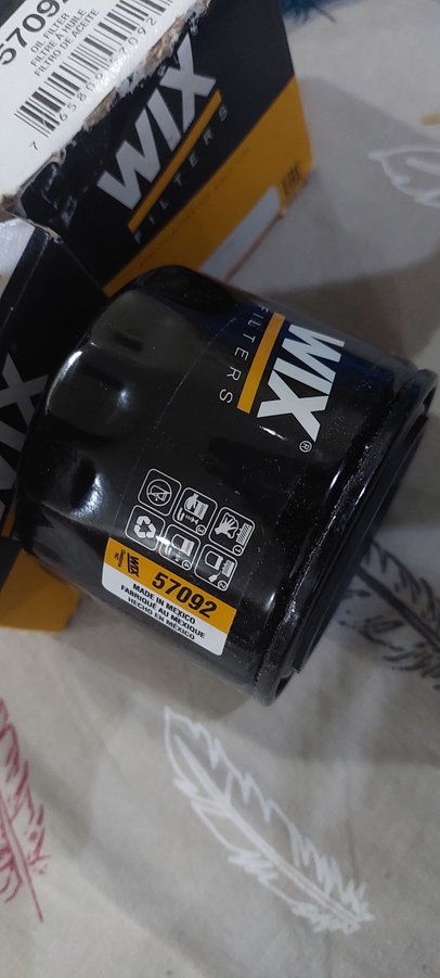

hello,
i just wanted to conform if this wix oil fikter #57092 is the correct oil filter for a 2005 evo 8?
​​​​coz every im confused as if this is for a evo 8 or a evo x
thanks

Yes, there are 2 filters you can technically use for the evo 8. I use this one you are showing. There is a short fat one and long skinny one. I prefer the short fat one for more ground clearance. I also use the M1 108A.

Yes that is correct, and btw they are on sale for $5.11 on amazon

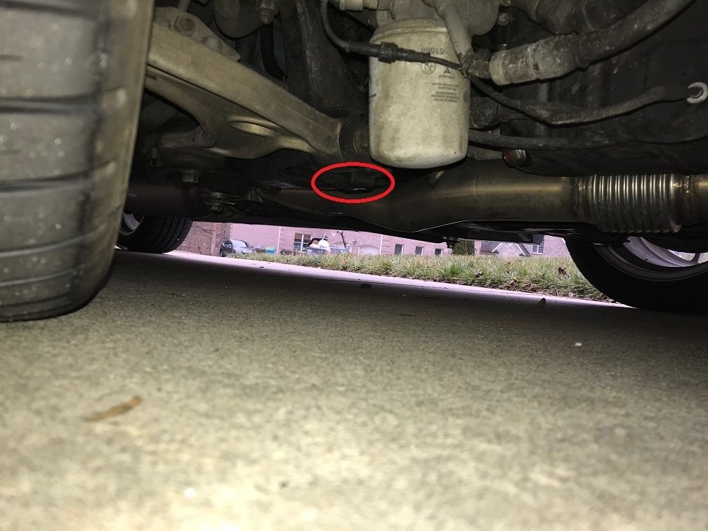

I've been running the WIX 51568, which has a larger filter surface area (177sq-in) vs the 57092 (113sq-in) and a higher bypass pressure at 16psi.

that WIX 51568 looks a bit taller... does it have clearance issues with road road debris??

No clearance issues with road debris or road road debris. Although it's difficult to tell from the angle of the picture, but the bottom of the filter is higher than the mount for the chassis stiffener bar circled in red.
