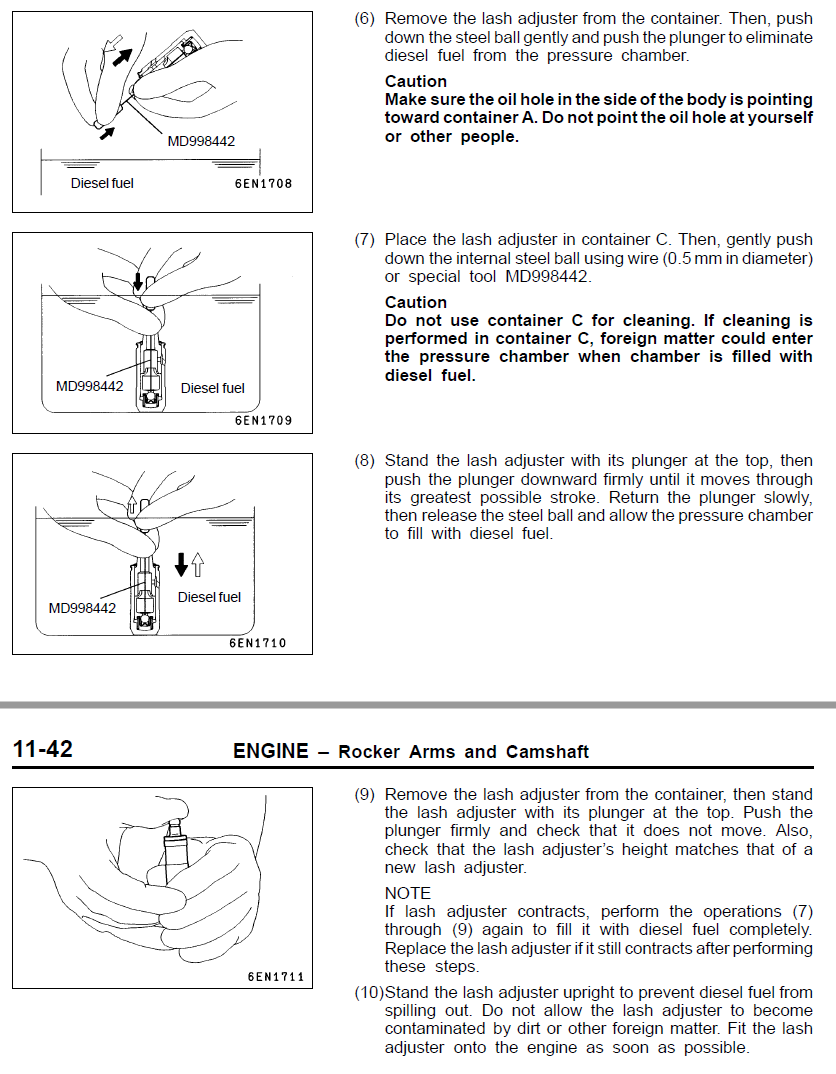

Mitsubishi manual states to install the lash adjusters cleaned and filled with diesel, is this incorrect?
Or is it correct and just not recommended?

Originally Posted by LetsGetThisDone
I find that causes them to tick. I install them fully bled down.
They take about 7-10 seconds to pump up and stop clattering on a fresh motor. Quicker if it's just a cam install. You can always prime the oil system before start up to get oil in them.
Also of note, if they're installed pumped up and incompressible. They're not longer adjusting lash. They're just a solid state fulcrum for the rocker. Installing them filled and incompressible doesn't make sense.
When you install a pumped up lifter, it will eventually bleed down to the camshaft base circle size/height.
That's the whole point of a lash adjuster. If they didn't bleed to the correct height, they wouldn't do anything.
I'm guessing that's why Mitsubishi says to use Diesel fuel, it's very thin and will allow them to bleed/adjust to the correct height quicker than using oil.
Example: if you run an aggressive ignition based cut, it's common for the lifter to pump up because the exhaust valve has been blown open with exhaust manifold pressure (EMAP). The lash adjuster is doing it's job and taking up slack in the system. This causes a "miss" for a short period of time until the lifter bleeds back to it's "normal" position.
