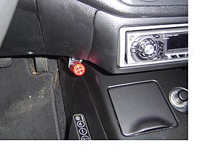

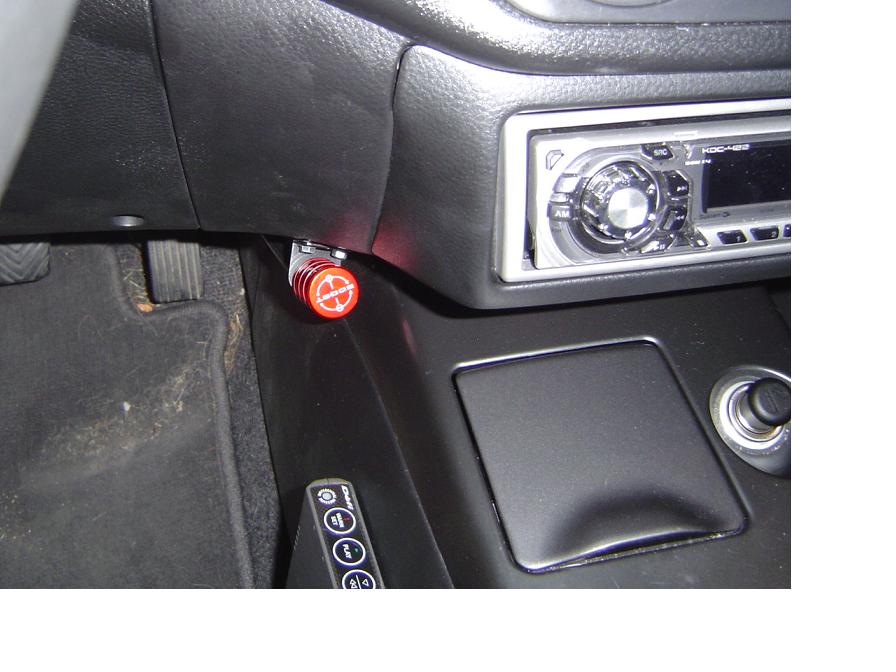

I have the Hallman Pro RX. It doesn't run hoses into the cockpit (no need to worry about boost control with long hoses). It has a flexible cable that basically just relocates the adjustment knob to inside the cockpit, much like the throttle cable links to the gas peddle. You do have to make a firewall penetration for the cable though.
Attached Thumbnails Anyone have a MBC inside the car?-pic16.jpg   Anyone have a MBC inside the car?-picture-013.jpg
I have mine in the exact same spot. I thought it would be in the way kinda with my leg hitting it and all but no problems here.
