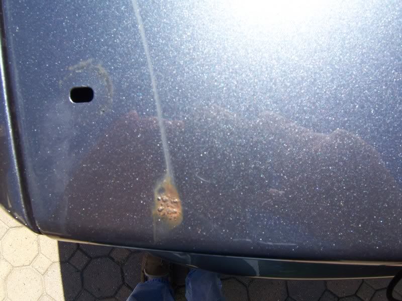

Guessing it looks something like this:

close but mine is a little further away from the edge.
STevo
